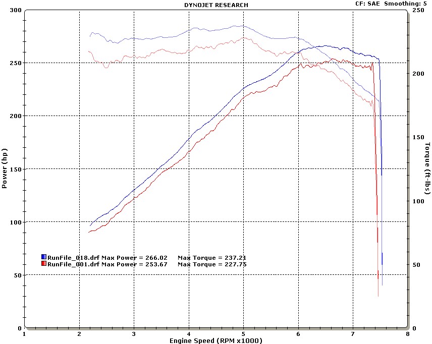

Dyno Graph Stillen Intake/Exhaust
For those skeptics on this thread who don't believe a better intake and exhaust can improve rwrhp and torque I've included a dyno graph of my car before and after.
Attached Thumbnails Stillen Intake Kits vs. Others-stillen_g35_intake_exhaust.jpg

Originally Posted by Svnrmk
I have just installed Stillen Gen2 Intakes on my car. They improved performance and I got the dyno results to prove it. ...
Basically, the dyno results are showing that I'm getting about a maximum of 8hp increase from 5000-7000rpm with ~ 4ft-lbs of torque increase in the same rpm range. Of course dyno results are heavily depending on test condition. The numbers were the best out of 4 run.
I would recommend a stillen cat back exhaust. I have this the on my car. On it own it can add ~10-15 hp at the wheels.
Although not directly related to this thread.
I thought I'd post the dyno results for my car with a Twin Turbo ...
Ok, call me a skeptic, but to be quite frank, you're kind of all over the map here.
Let's summarize . . .
You originally posted that your intake gave you 8 hp and 4 ft.lbs tq. in the 5-7k rpm range. Then, over two years later, you make a post stating that the exhaust ALONE can add 10-15 whp. When I questioned you on it, you didn't back it up, instead offering a (distracting) dyno of a turbo setup. Now today, you post a dyno supposedly showing the results of your car with BOTH intake AND exhaust. Yet even with that, the plot only shows a gain of 12.35hp and 9.56 ft.lbs.tq., with the bulk of that happening in the 5-7k rpm range.
So essentially, you are contradicting yourself here somewhere. If the gains from the intake alone accounted for 8hp and 4 ft.lbs tq. in the 5-7k range as you originally stated, then that means the exhaust ALONE accounted for something more like 4 hp and 5.5 ft.lbs tq., NOT THE 10-15 whp which you had claimed and which I had (skeptically) questioned.
I'm not trying to beat up on you here, it's just that people look to this info for real world experience for guidance on how best to spend their hard earned dollars. The least we can do is offer the most accurate information possible.

Yes, you are correct. I should've been more clear. The combination of intake AND exhaust improved rwhp in the 10-15 range as well torque. Thanks for pointing that out to everyone.
A 12hp, 9 ft/lb gain is pretty impressive for the combination. And yes most is its going to happen in the 5-7 rpm which it should. the HR engine generates most of its power in this band.
Have you actually improved your car with these or any other mods? Do you have data to share on why you've done that may benefit others? Or are you just here to criticize other people posts.
It have since moved forward from these modifications and my car is now a Twin Turbo setup. So digging up this this old information took some time. Hence the delay in posted the dyno results.

Anyone with half a brain is going to "criticize" and analyze your post, especially when you spout off questionable numbers and contradict yourself with data that goes against the norm. BTW, VQ is legit and all he asked for was clarification on your numbers.
Don't take it personal, it's the internet.
... are you just here to criticize other people posts.
Certainly not, and would be unfortunate if you interpreted my posts that way. The simple fact is that you made a recommendation to people here and noted performance claims which seemed implausible (as you've now acknowledged yourself). Again, I was never trying to beat up on you or criticize you, and I don't believe I have. Instead, I merely sought the most correct information available. I am sorry if that has offended you.
