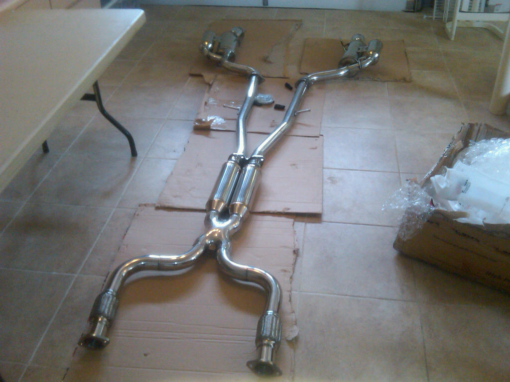

My brace is facing down towards the ground but I'm not sure if they are all welded the same way. The difference on our version should be on the passenger side to accommodate for the transfer case here's a pic

Yeah but on the one i have both sides were extended before the x and then the pipe after the resenators was shortend to get around it. I beed to flip that part over but thats not causing the whistle.. lucky it didnt do that on your car at all rite?

^+1 on sound clips and flipping the x-pipe!
i think that x-pipe is whats causing the whistle, i think it only fits on one way...? unless you twisted the bendy part...? if you look at the bolt patterns on both sides on lefizzet's picture, they are tilted a little upwards on the inner area...

It works both ways.. but i will fix it. I think the noise is from a small leak

i hear a whistling sound in the video, is that what your talking about? if it is, then i definitely did not have the whistle. it could be from the HFC. where do u think its coming from? assuming you double check all the bolts, gaskets, piping. i tried to label everything to make it easy.
i was confuse also which side the Y pipe should be, if the brace was suppose to be up or down. but since i had it up, thats the way i labeled it and it worked for my car.
