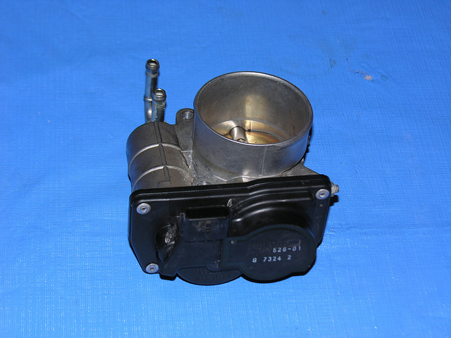

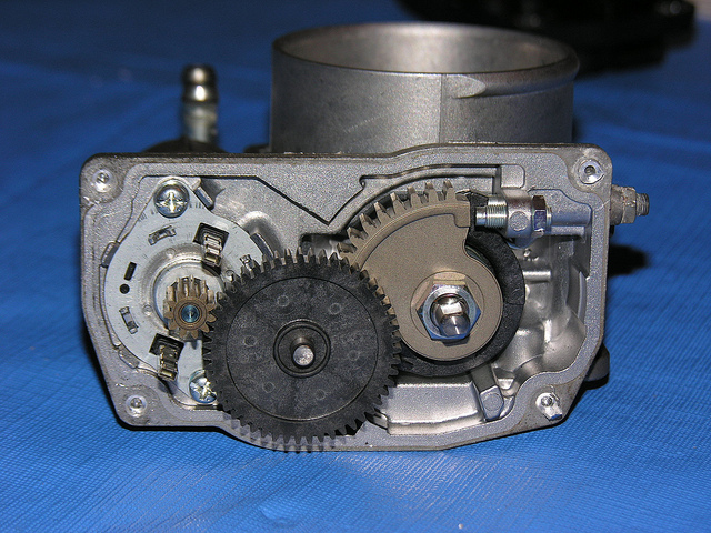

I posted this elsewhere looking for help with my crazy idle after throttle body cleaning but to no avail and still working on it but here's some quick pics of inside our throttle bodies held together by 4 rivets easily drilled out. Pretty cool stuff.

Yes we have a drive by wire system, wondering why you took off those plastic covers? was it just to show us all? there is a idle relearn procedure your gonna have to do. I have not done mine yet,, (cleaned TB's) or you might have to go back to dealer.....

Why in the hell would you drill open the TB?
If you had done a little research here, you would find out that the ECM must "re-learn" the TB control after you have unplugged the TB and then TURNED ON THE KEY. If you do not turn the key on, there is no problem.
So look around and find the re-learn procedure.

Wow! Everything in our car is plastic
