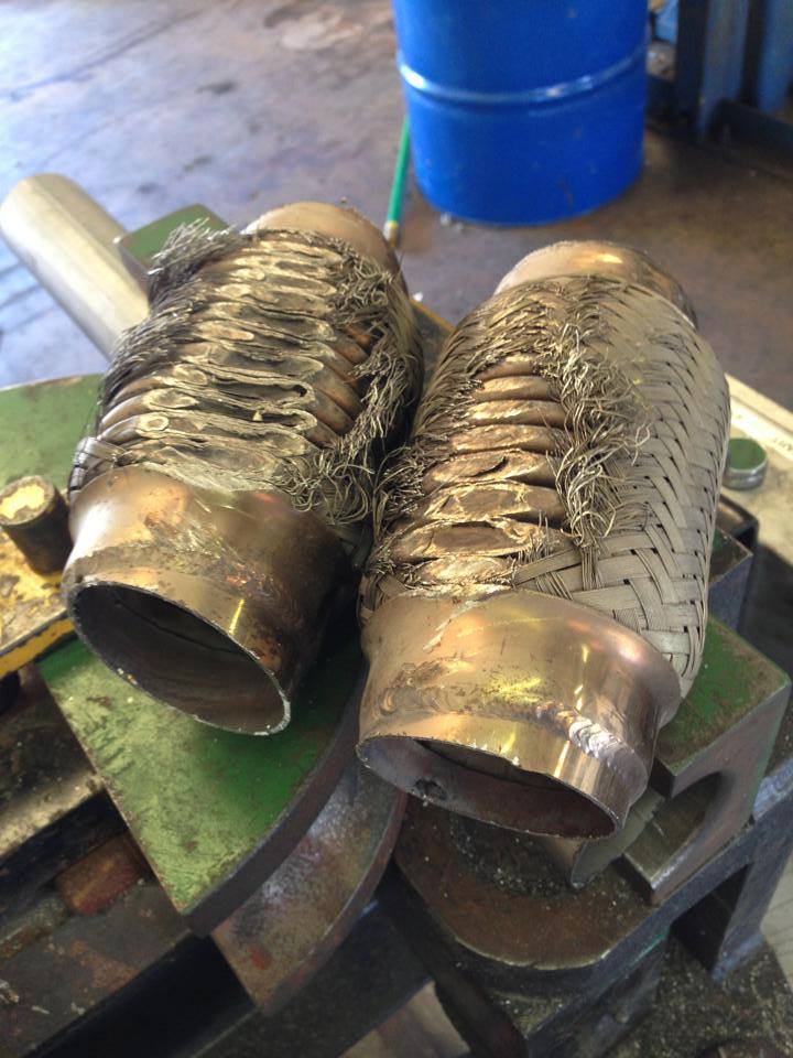

Yup best sounding, but also hangs too damn low.
Here is what your flex pipes will look like eventually:
Review: ARK Grip Cat Back Exhaust-u2bgn4f.jpg

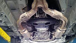

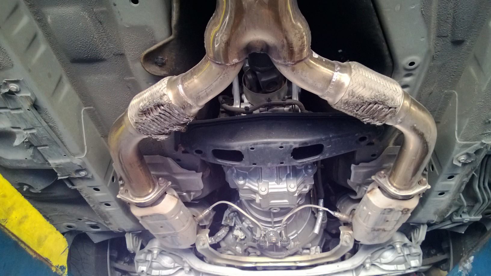

Mine were leaking so I had them cut off and had new ones welded on.
Review: ARK Grip Cat Back Exhaust-h8b4ipr.jpg
