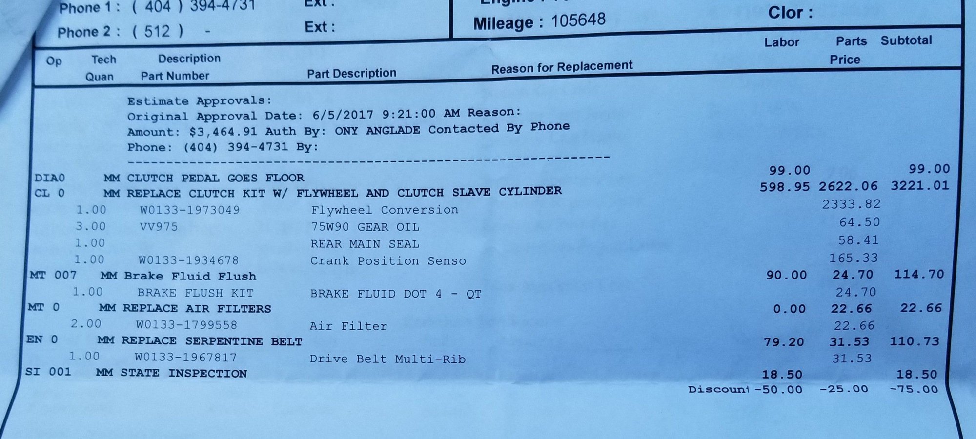

I'm not exactly sure what I'm looking at? Did they authorize the repair as part of that "voluntary replacement" ?

It's the repair receipt from last June from the previous owner. He did the clutch, flywheel and slave cylinder right before he sold it to us. Plus rear main seal, crank position sensor and serpentine belt.
So those slave cylinders really do suck.

Wow... I know they had a pretty high failure rate but I DIDN'T know it was happening on brand new items like that. I would definitely get the CSC relocation kit installed if you plan on keeping the vehicle. The cost of the parts is a little spendy yes but cheaper than the cost of having the transmission removed next year for ANOTHER CSC if you're so unlucky...

Does that shop offer a warranty ? I'd be tempted to ask the previous owner to help you out on this (even pay him something for his troubles!).

Hot to the damn!
It has a 2 year /24k warranty.
I called and its transferable!
Wow, what a turn of events.
