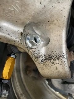

Ordered a front set of Whiteline end links to go with my Hotchkis sway bar. The bolts are too short leaving very little secured thread. Any ideas?
Front passenger side

i found the same issue with a set of oem style sway links , they went a bit farther than yours are looking but i tightened them down as far as possible and haven’t backed out yet

Yeah, as it turns out, the ones I bought were for the V35 chassis. They're marketed for the 2007-2008 G35 sedan so even aftermarket manufacturers and their vendors are confused about the differences between V35 and 36. I know now.....VQ35HR V36 spec and I make it a point to note this in the comments section when ordering anything.
