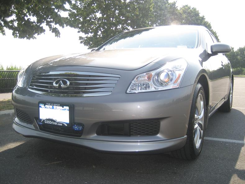

Hi! All Fella G. What Spring kits should i use for lower mine 08 G35X
I know there is an issue with the X but many ppl using Eibach Pro with rear camber kits? I just want 1-1.25 inches low. Not more than that for NYC
Any advice would be appreciate.
