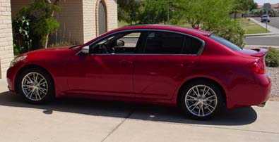

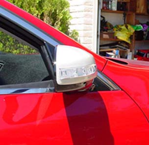

My first attempt to post pics of my signal mirror installed
I will get them painted later next week. It only takes a few seconds to remove them and put the original covers back on.

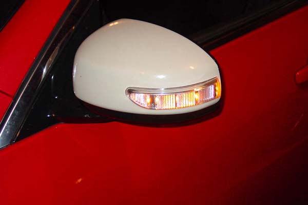

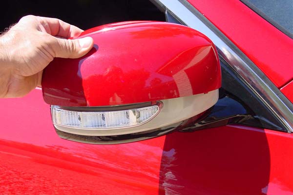

More pics
More pics
Attached Thumbnails I spent the day installing Signal mirrors on my Sedan.-255k.jpg   I spent the day installing Signal mirrors on my Sedan.-264k.jpg   I spent the day installing Signal mirrors on my Sedan.-266k.jpg
