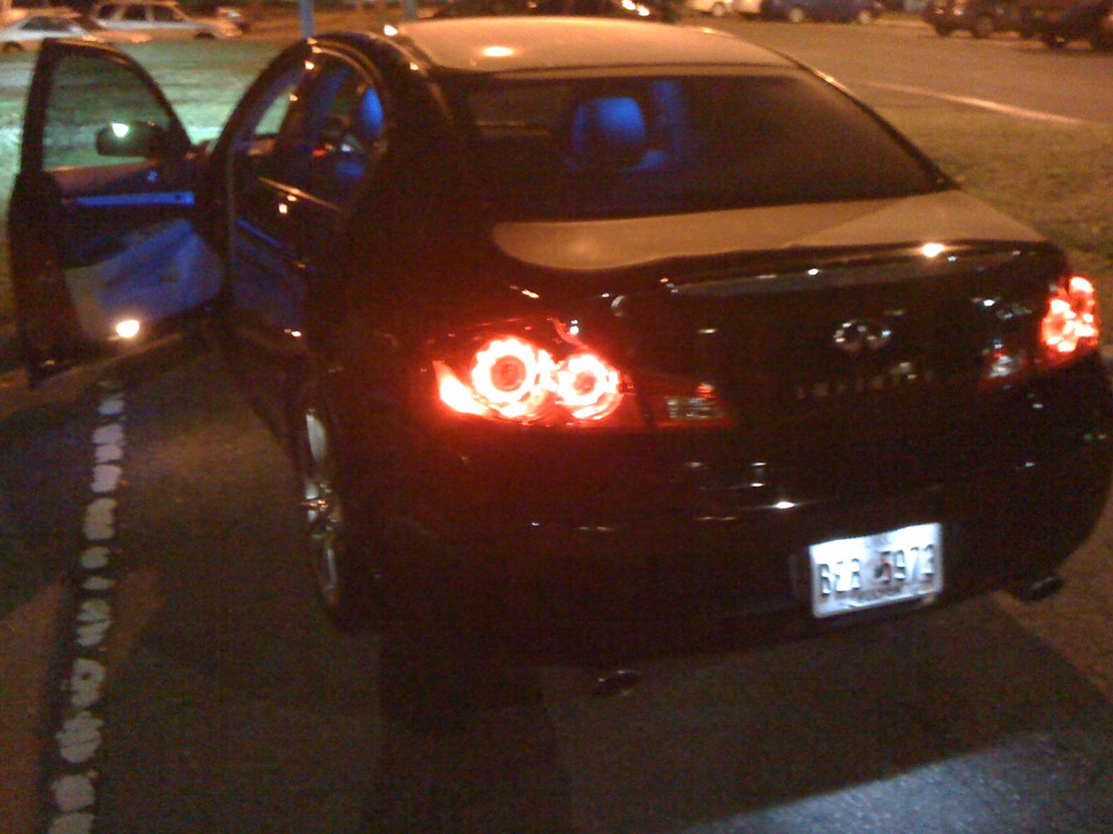

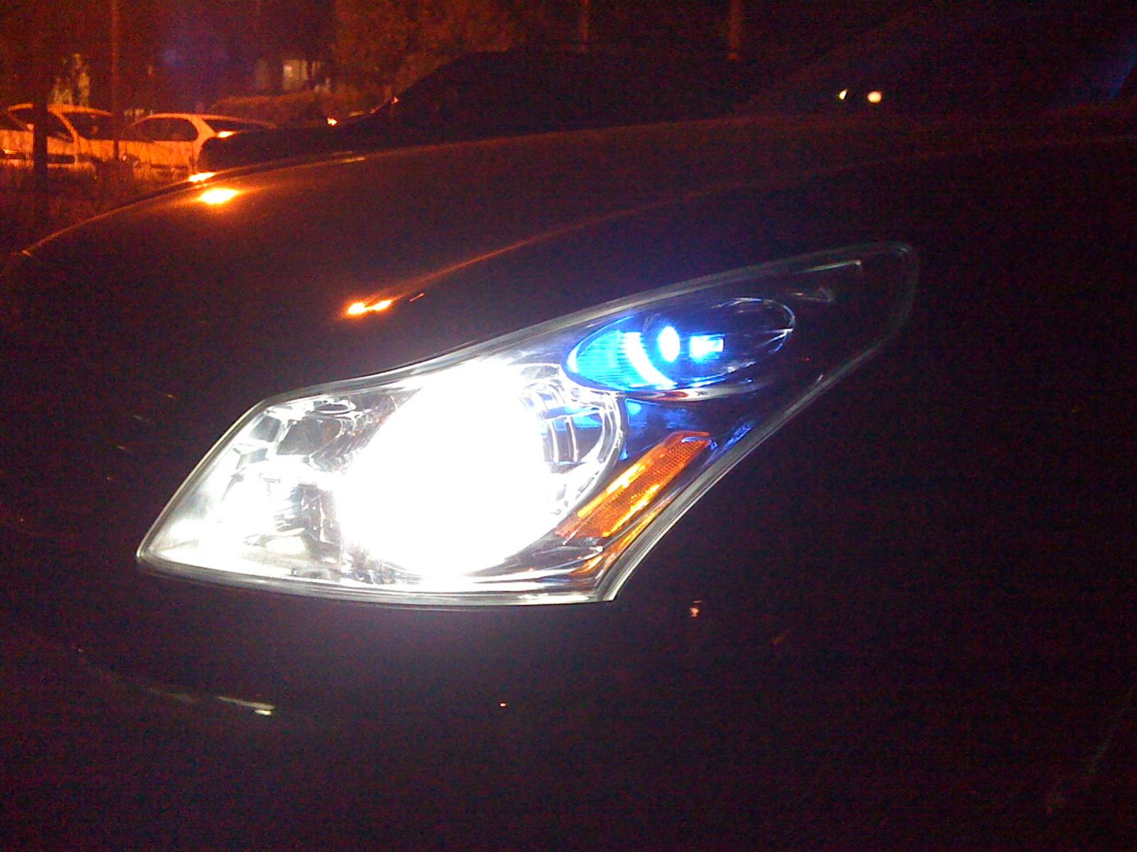

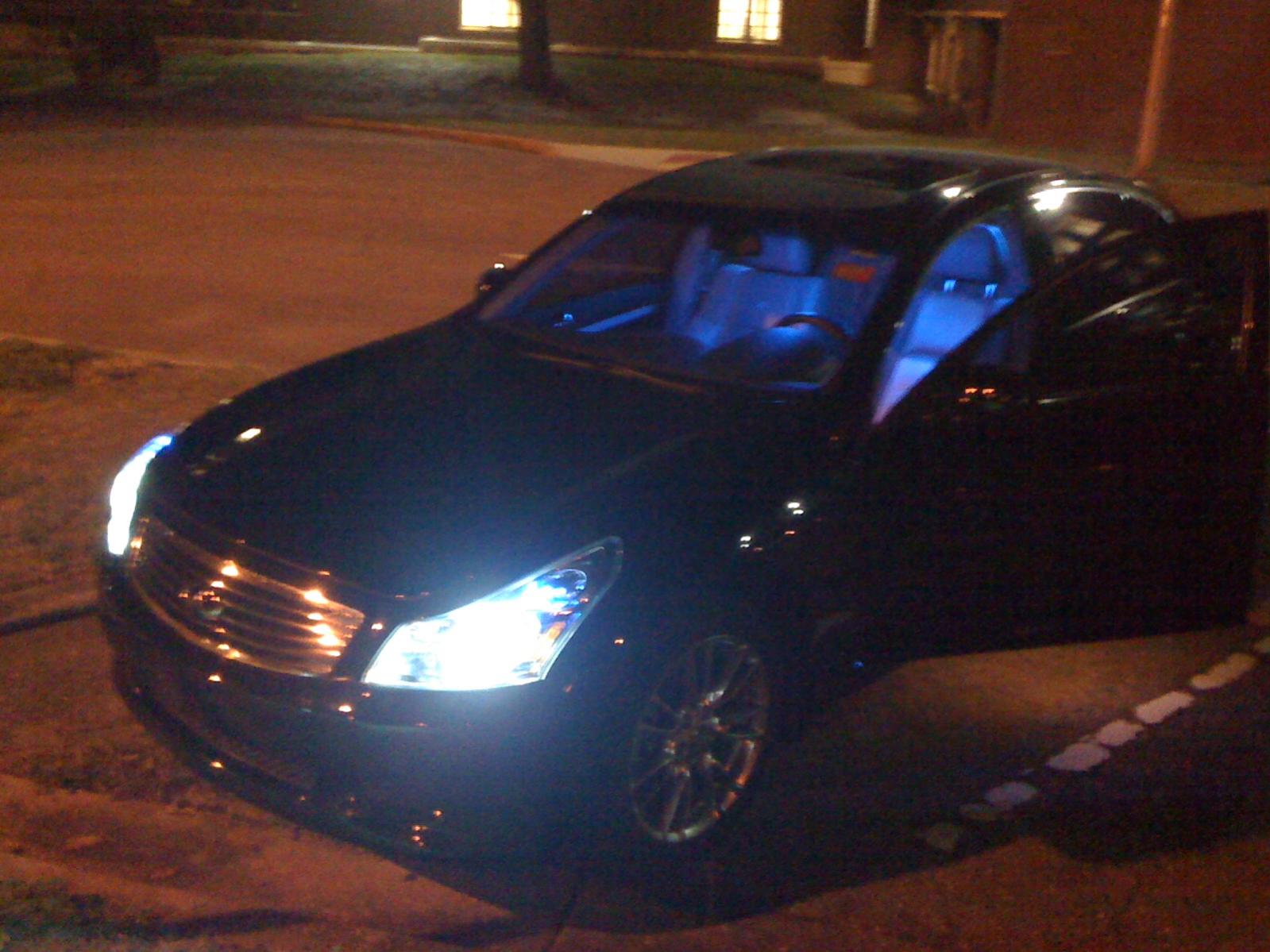

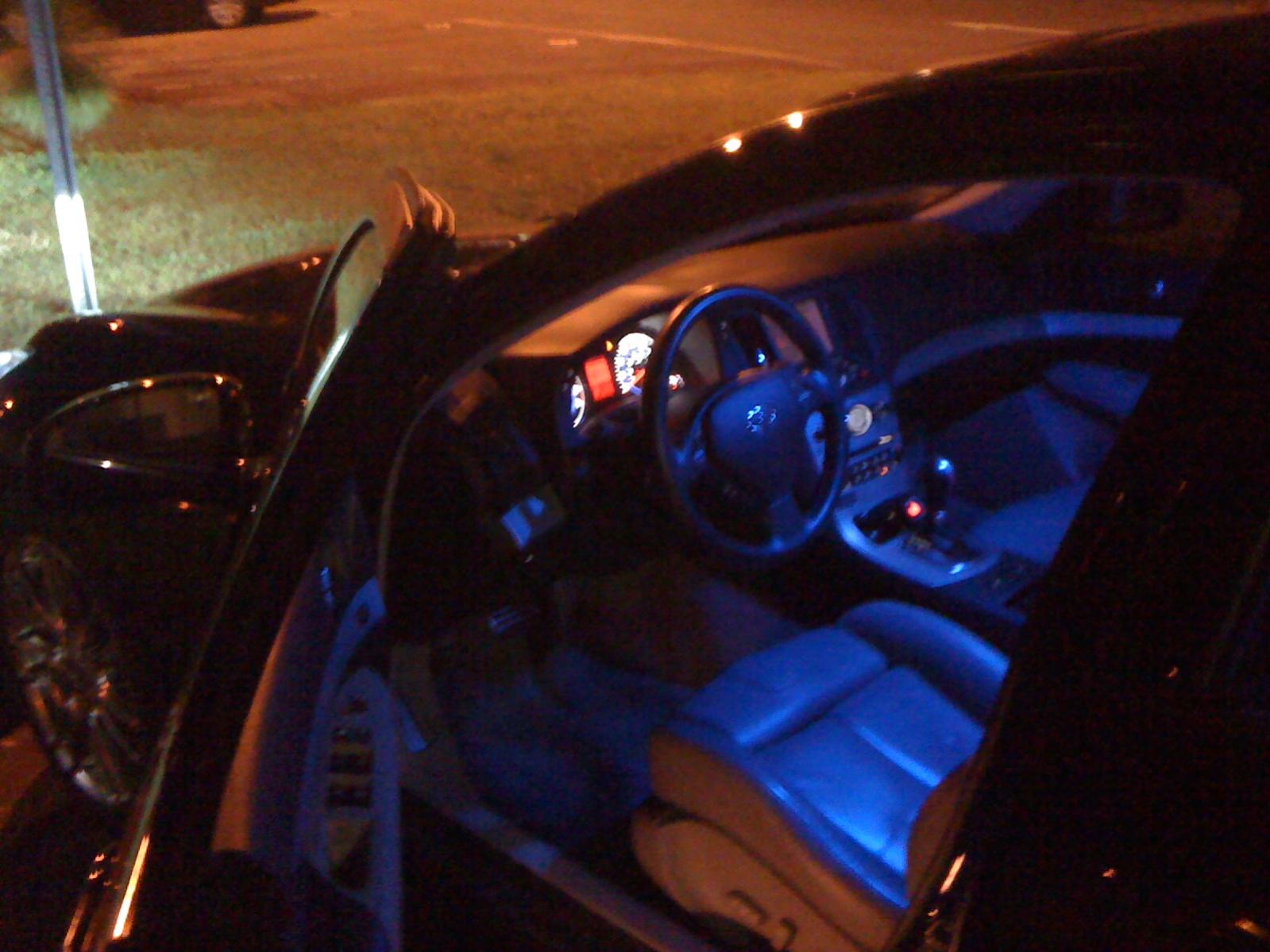

Here are a couple of quick pictures i took with my cell phone, im going to borrows camera soon and put up better pictures. most people go with the xenon white lights from them so if anyone was wondering what the blue looks like here you go...
btw, put in xenon white on license plate, and blues in parking light as well as trunk
that ****'s so illegal isn't it? Blue lights in the interior, even if your car isn't moving and there on.
However I like it especially the license plate light, btw what did you end up using for the parking lights?
i've gotten nothing from cops about it, and i've ridden around at night with them on all the time. i'm pretty sure you can do anything with your interior that you want, only thing that could be illegal is my blue parking lights but the led is so small most wouldn't even notice/think it is stock. anyways, might look a little cheesy on those cell phone pics but its definitely something you gotta see on the road. have gotten nothing but compliments from just about everyone i pull up to, highly recommend it. ill try to remember to take some higher quality pictures if you want me to

And installation is very simple. I don't have much experience with cars but its simple plug and play for the domes, map lights, trunk, and rear passenger lights. License plate was a little more difficult, you gotta unscrew the housing above the plate and remove the stock housing to get to the bulb, then just a little difficult getting it back in. Parking city light (little bulb in headlight housing was hardest): I jacked up the car, turn my wheels to the inside of whatever side I was working on, pull down flap in the wheel well, and then you gotta remove the parking city light housing/wire to replace the bulb in it. If it sounds harder than it is, you just gotta play with it to figure it out, thats what I did. Plus if you've ever replaced headlights, the parking city light is the wire right above the D2S housing.
