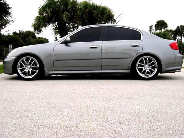

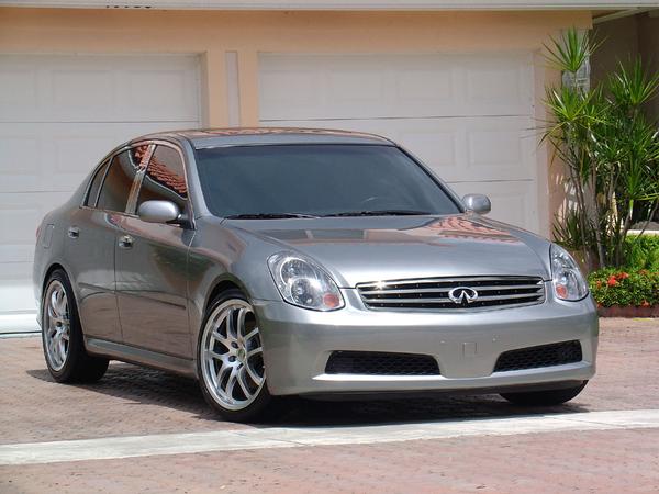

i have had my fenders rolled with a special tool that bolts on to your hub and evenly rolls your fenders all the way around preventing any chipping or cracking. you will definately want to have them rolled no matter what ur drop is and possibly switch over to a 245/35/19 series tire for the rear instead of 245/40. thats just in my opinion, ive been rolling on coupe 19's for quite sometime now but i have some 20's on the way finally! if you want some mint chrome coupe wheels with plenty of tire thread left let me know lol
...heres a photo when i just had tein h tech springs:
19" Coupe Wheels & Sedan, Fender Rolling/Shaving-1128674692_l.jpg
this is a photo with the apexi adjustable coilovers
19" Coupe Wheels & Sedan, Fender Rolling/Shaving-l_337bada3f59c70ebd1bf56807cd6f4dc.jpg
Old Feb 27, 2007 | 12:50 PM
ttrank's Avatar
Grocery getter
iTrader: (57)
Posts: 27,305
Likes: 190
From: Phoenix
Attachment 64650
Attachment 64651
