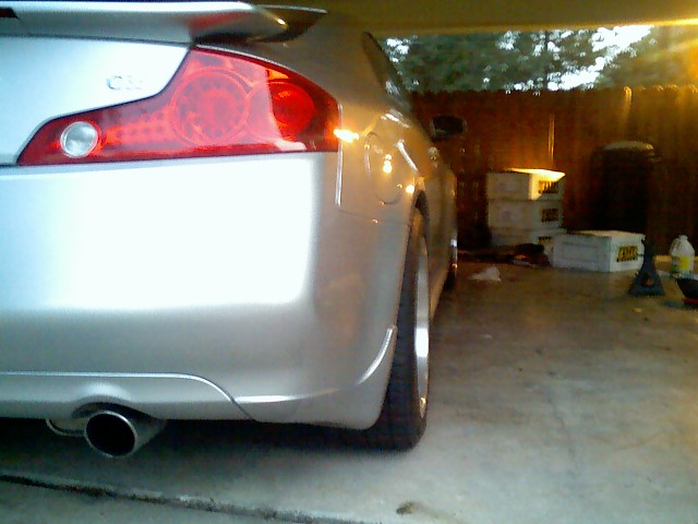

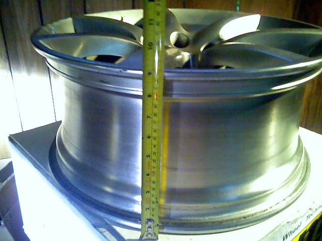

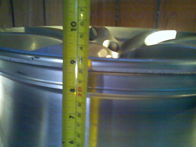

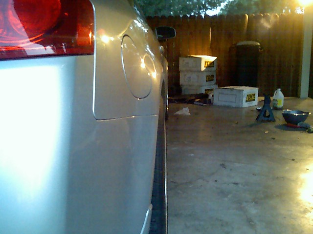

Sorry about the crappy camera pics, but I didn't want bad information floating around. I just happened to have my stock 18x8.5 wheels sitting in my carport so I took a couple of quick pics before I left for work this morning.
As you can see, the bead is about 1/4" wide, so measuring from the insides of the beads, the rear wheels is 8.5" wide.
I also took a couple of pics of the rear wheels. As you can plainly see, they are not sunken in whatsoever (as somebody earlier stated there would be).
