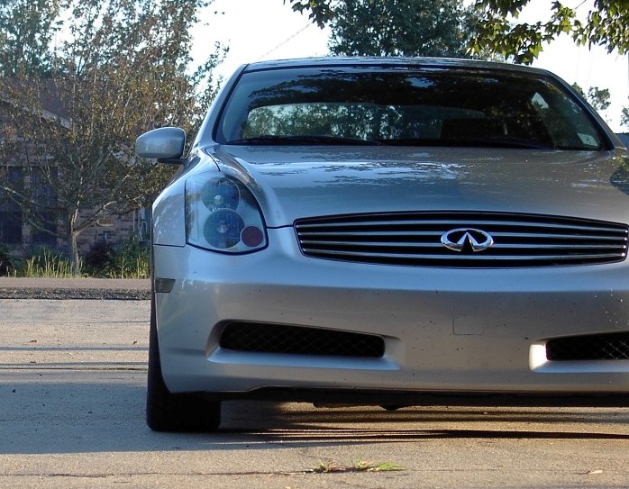

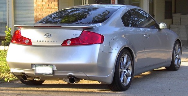

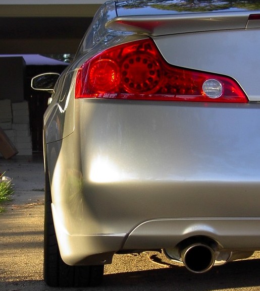

20/25
here is 15 front, 20 rear.
https://g35driver.com/forums/attachm...4&d=1160793460
https://g35driver.com/forums/attachm...0&d=1160793433
https://g35driver.com/forums/attachm...8&d=1160793642
https://g35driver.com/forums/attachm...0&d=1160793642
https://g35driver.com/forums/attachm...1&d=1160793662
https://g35driver.com/forums/attachm...2&d=1160793662
those are still tucked, IMO.
even he realizes he could have gone more.
