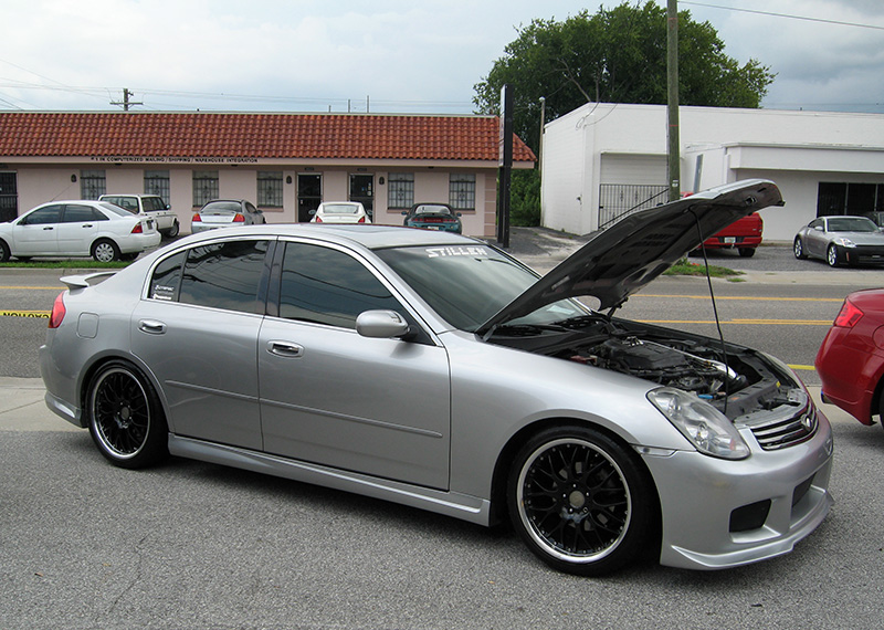

You want to stay in that +40 range for sedan wheels, if you use that spacer, that's going to be too much, if you go with 18s they will probably be 8.5 or so. The offset range should be +40 to +45. The pic below are +42 all around.
Attached Thumbnails What rim/tire/offset combo to get??-rzmotoringcarshow-6amoises.jpg
