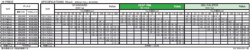

I've been trying to research on good offsets for my 04 2dr coupe with brembos. I wanted some pretty aggressive offsets, and am thinking about 19x9.5 +17 and 19x10.5 +18. But I've only been able to see these offsets on volks, and not on the work rims. Any opinion on this? will it fit fine on my car? and how big will the lip be on the front? Any mods to fenders? I can't seem to find a good pic of one. Thanks for your help in advanced.

I recommend you roll your fenders with those offsets. You won't rub on 275's with a mild drop and no alignment. But if you slam it, you'll be risking it. And you most likely won't be able to run stock camber settings if it's slammed. But once you get your fenders rolled, you'll wish the wheels were a little more aggressive after you see that extra space you have
I have Volk GT-S with those offsets. I wish they were 0.5 wider with slightly more aggressive offsets!

https://g35driver.com/forums/attachm...sedan-work.jpg

I'd say that's a mild aggressive offset. get into the single digits, zero, or negative offsets for really aggressive.

Those are decent offsets, but if you're custom ordering those widths, I'd advise +10 all around or lower, depending on how much you're willing to do to make them fit.

If anything Rays offsets are pretty limited. I am pretty sure Work can make any sizes to order if you have $$$$ in hand.

you WILL want more!!!
