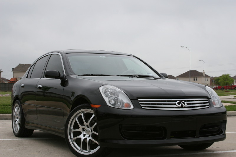

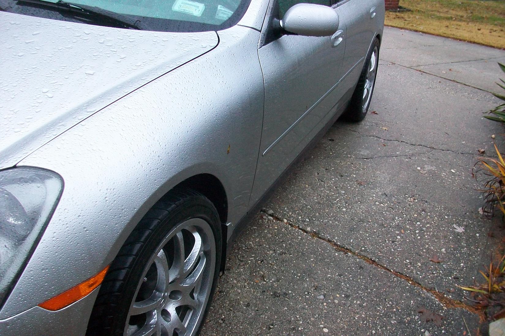

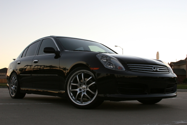

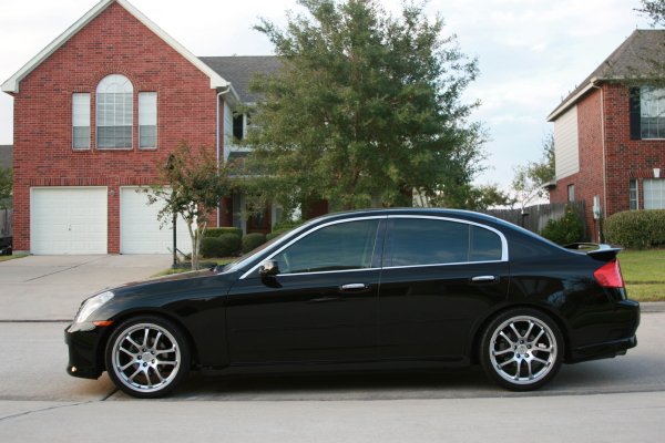

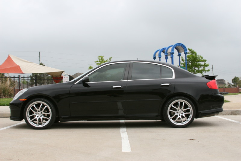

Definitely think that the sidewall size is too great. You need 245/35 in front and 255/35s in the rear and you will have NO rubbing and no issues. Also, you need z springs up front to lower by 1" and g cpe springs out back to lower 1/2". That also helps tuck the wheel in with some slight neg. camber. However, they really don't stick out. The hella flush look is great and imo they do not stick out at all. I think if you don't lower it, the rays 19s on stock springs looks dorky/nerdy. Here is some b4 and after shots.
I rolled my lips out back as precaution to allow use of 40 series tires with no rubbing. 35 series looks the best and rides/handles nicely. I understand about your crappy roads etc.......so I understand about you wanting to keep stock height.
before............................................ ..........................................after
