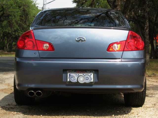

I'm running 245/40/19's on the coupe 19's dropped 1" all around and have no rubbing anywhere. Had 245/35 up front but didn't like the look or the ride so went with 245/40.
I was thinking about 255/40 in the rear but after looking at your pics, will probably stay with the 245's.
I thought about going 255/35 in the rear but here's my dilemma. I want to keep the diameter of the tires as close to each other as possible (F/R). That's why I was pondering the 255/40's. These are the diameters of each combination:
245/40/19 26.7"
255/40/19 27.0"
255/35/19 26.0"
Therefore the 255/40's were closer in diameter to the fronts than the 255/35's. Plus I'd get a better ride with the taller sidewalls.
So after all that, I'm going with 245/40 Vredestein on the rear when the Falkens wear out. They run a little wider than most tires so they should look good.
Here's how my back end looked before the HKS:
Here's how it looks now:
