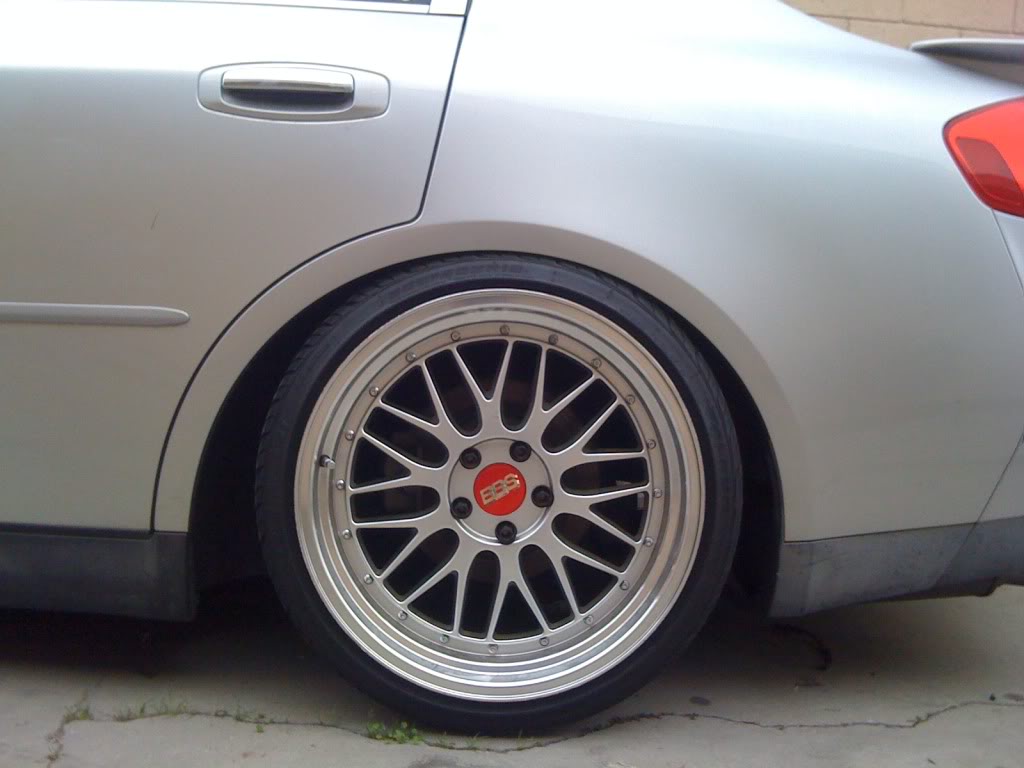

not to bump a dead thread, but i figured you might need help still. I just picked up some BBS LMs and the god damn hubcenters were designed for lexus!! so i took the hub rings out of my 25mm spacers, and put it on. Its working great so far, the spacer hugs the hub ring and the lug lines up perfectly. I mean it's still doing it's job, making the rim centered to all the lug nuts.. just run "non-hubcentric" spacers and check if it hugs the spacer.
i haven't got a chance to ride on it because my front suspension is leaking, so don't quote me on this but that's how i got my wheels to fit on last night.

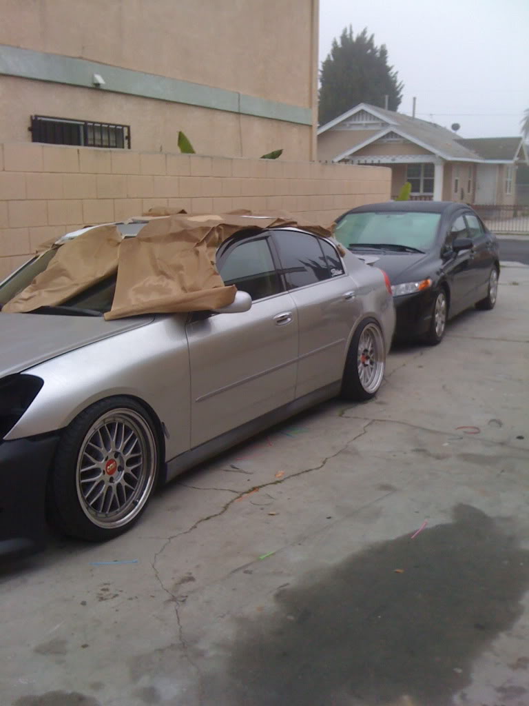

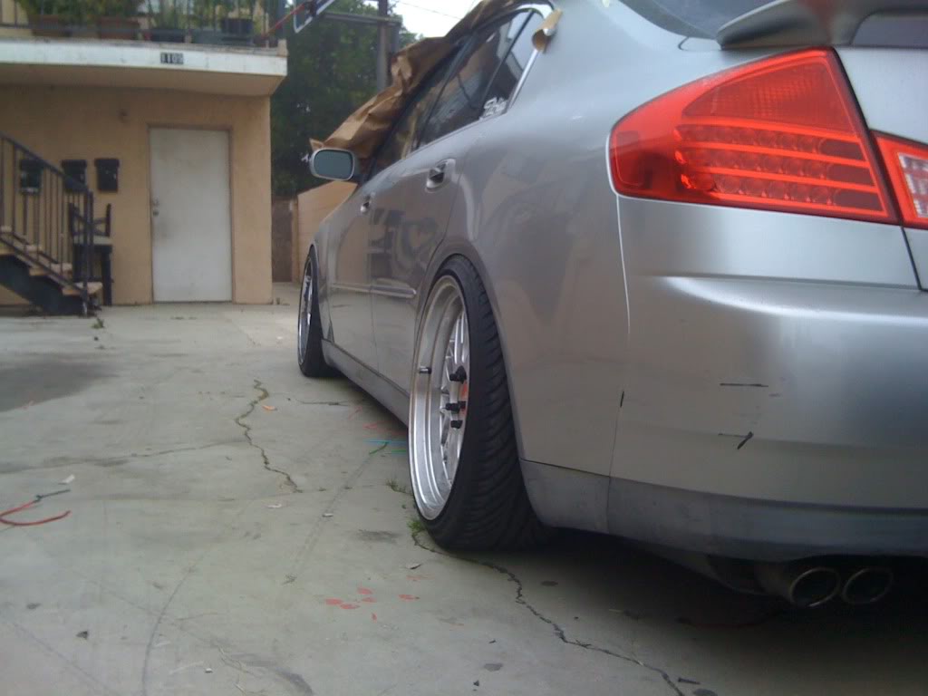

19x8.5/9.5+31 but with my spacer it's +6 I'll show you pics in just a sec.
I'm aired out in the back, it won't tuck cus I don't have aftermarket camber, or fender work. All my money went into my suspension.. One of the fronts are coils because I keep getting pulled away from my car by other customers. =/ Air suspension is pretty high maintence either that or I'm just a OCD *** hole.
