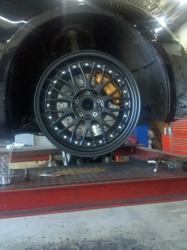

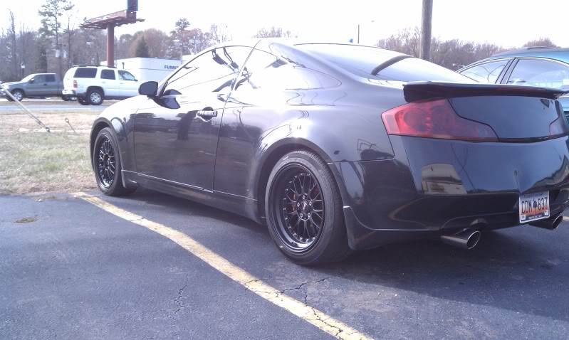

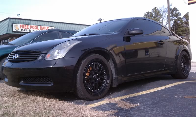

Actually, you don't need spacers to clear the brembos on this set up. I've had this exact setup on my car for a week now and it works just fine. I will be doing 15mm spacers just for the look later on, but I also reused my current tires to save money. So here's my set up with pics.
18x8.5 +30 with 225/45
18x10 +25 with 245/45
front
I have gold rivets on order and will be putting on coilovers and more most likely tomorrow. also I can tell you the best place to order the wheels but I will do that in PM if you like. I'll say I paid 630 shipped including the gold rivets which are extra.

Wow! Yeah my wheels are being shipped to my house in Canada so shipping and duties really screws me over. I went through next level motoring. I was unsure about going with 10" wheels all around. Also, if I want to sell them later on, I'm sure most other cars couldn't accommodate a 10 all around setup. I guess I'm just going to space the heck out of them in the spring time.
Those look sweet on your car!
