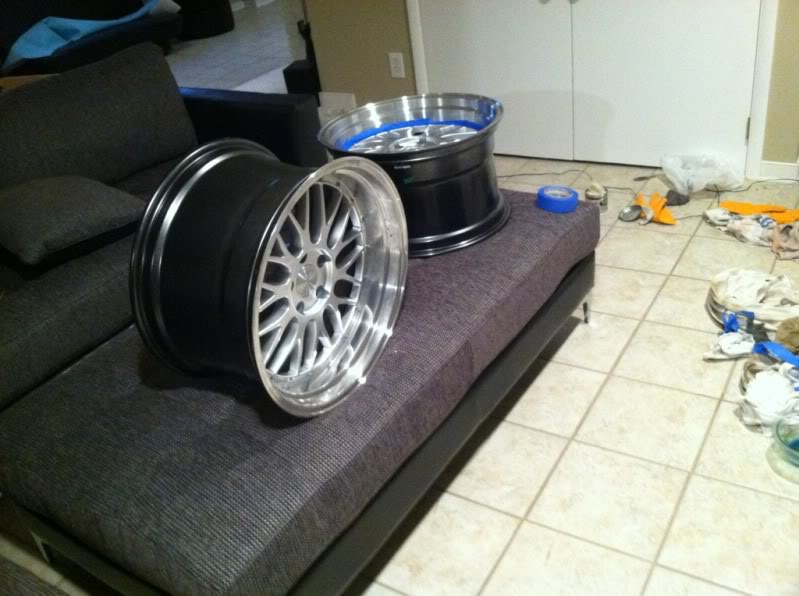

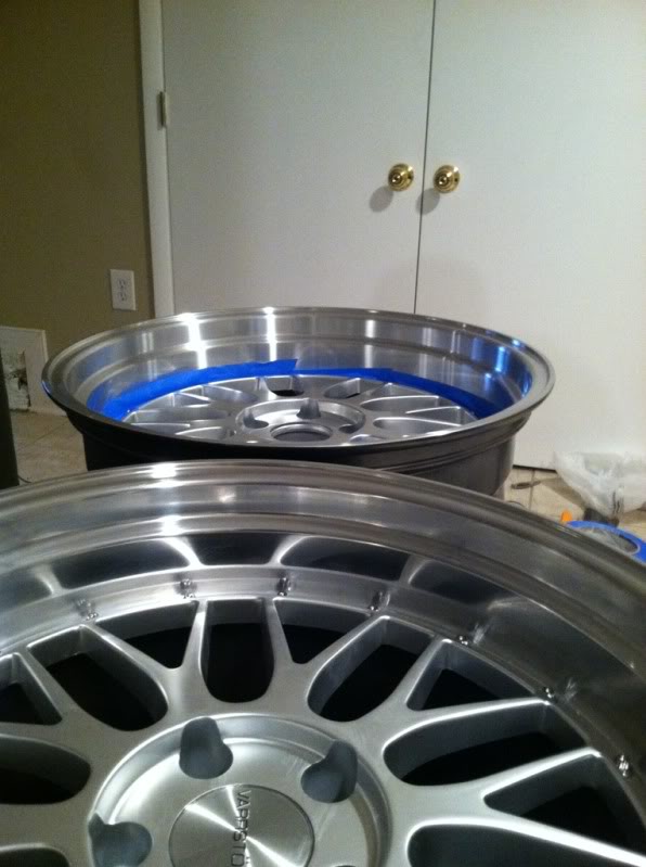

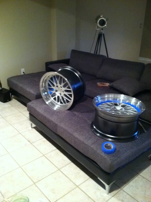

BTW I stripped the clear on 1 and have been testing some polishing. Here is a shot. I only polished 6" on the lip, which is the shiniest part below. I am finishing all of them tomorrow.

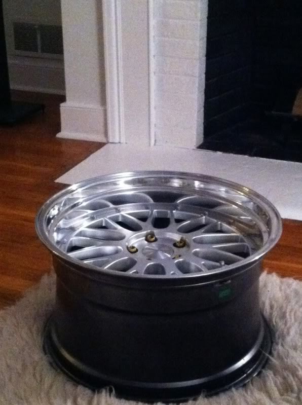

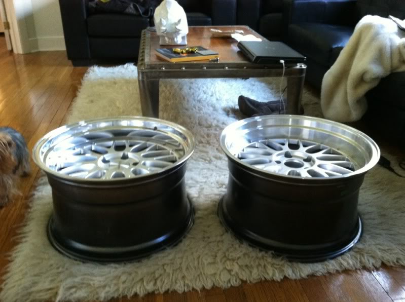

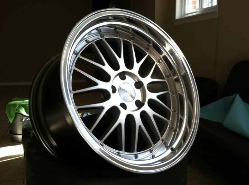

Done.

seems like it needs more shine.. . how are u doing it?

Sweet! Share how you got them mirror polish

Aircraft stripper. Then use wd-40 as your wet sand lubricant. 800-1000-1500-2000 then 0000 steel wool then jewelers rouge on a drill powered polishing pad, then mothers polish, then 3 coats of optibond.
It is a mirror shine, the first set of pics where just a 2000 and polish test spot. The most recent is 3-4 hours per rim, finger bleeding process. The hardes part is sanding out the grooves in the machined lip so it's flat.
