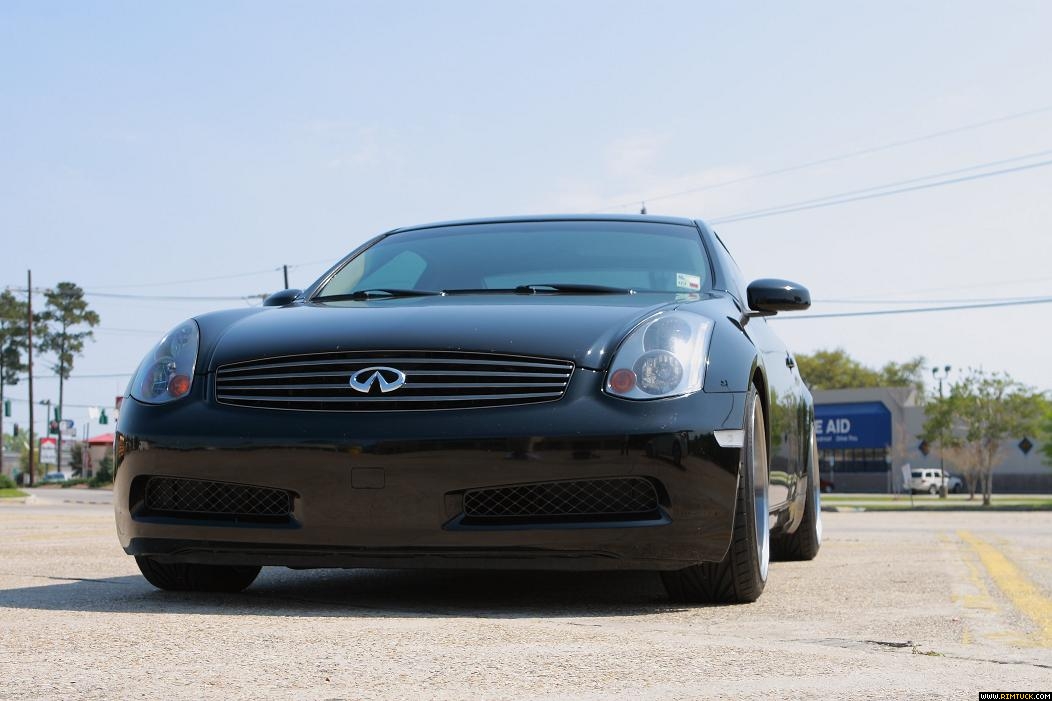

Yea you'll have lots of room with a 19x10 +30, like look here
That's with a 255/35, see the MILD stretch? The 255/40 should get rid of that so I would run the 255/40.

Your car looks awesome ! Perfect fitment with wheels and tires.
ok good, 255/40 it is, 295 only come in 295/30..
Thanks for clearing my mind about tireracks response, was a bit rattling.. !

That's actually not my car lol it's the one you posted from rimtuck.com.
This is my car
The 295/30 is a little on the small side to be honest.

That's actually my 18x11 +20 setup haha.
