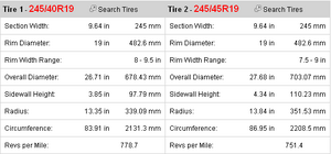

245/45/19 instead of 245/40/19 in rear ok?-tyuau.png
Pretty big height difference...

Yeah its half an inch. Has anyone actually put 245/45/19s on their car? If so please let me know how they worked. Thanks in advance.
