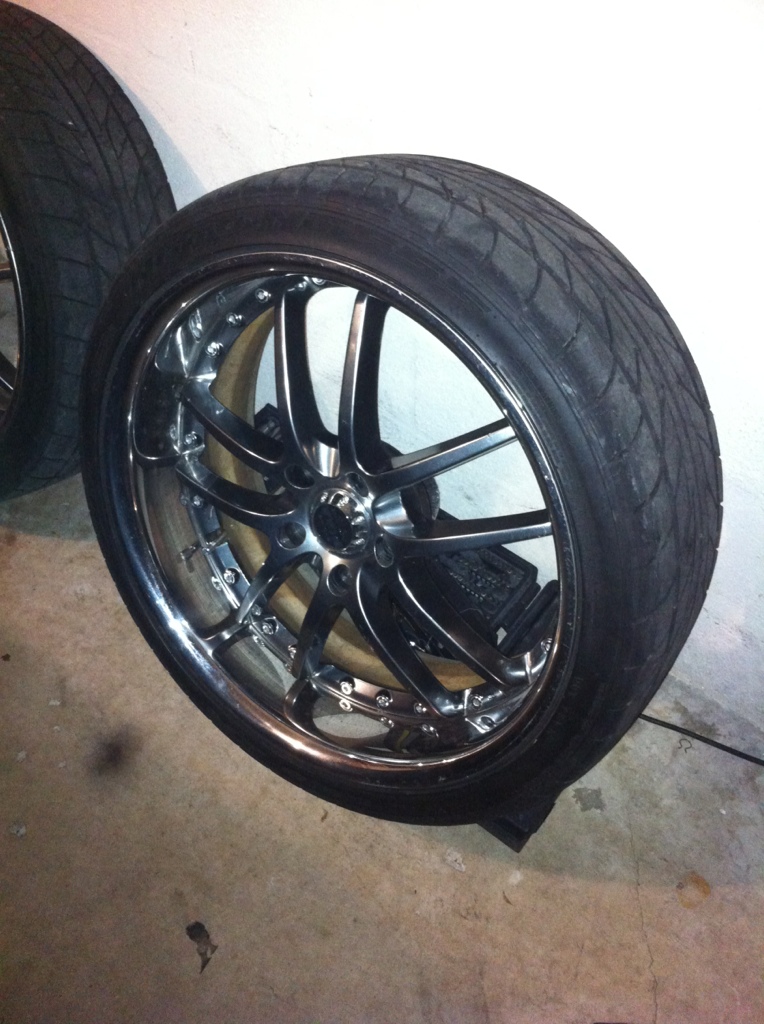

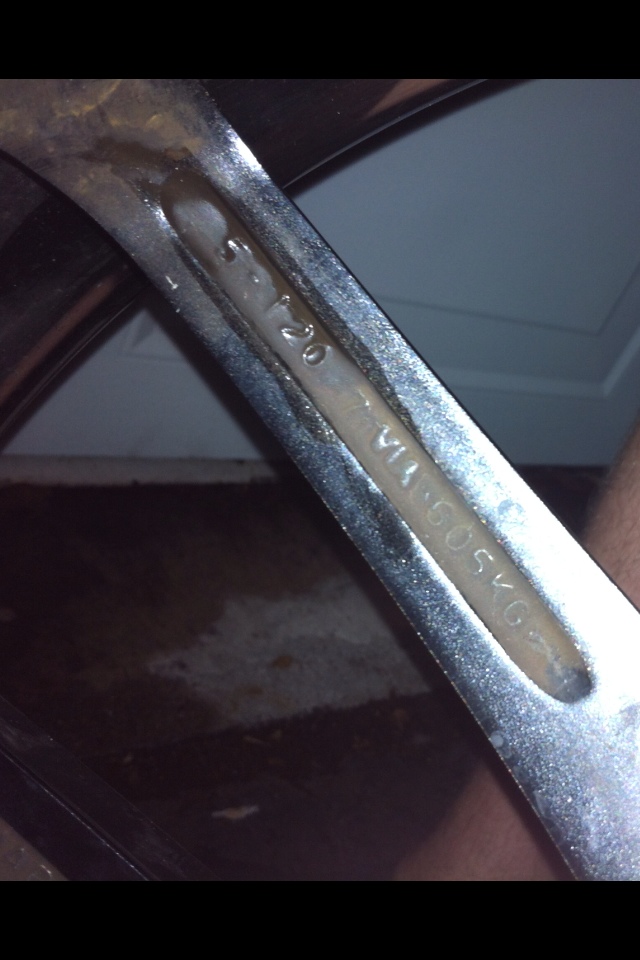

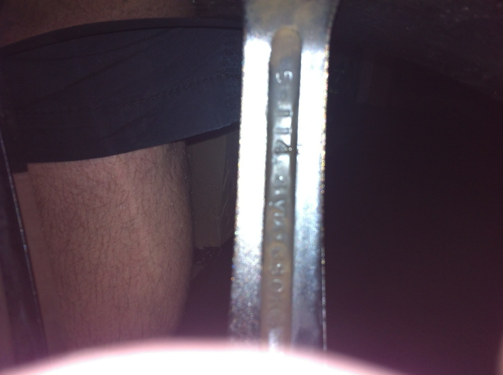

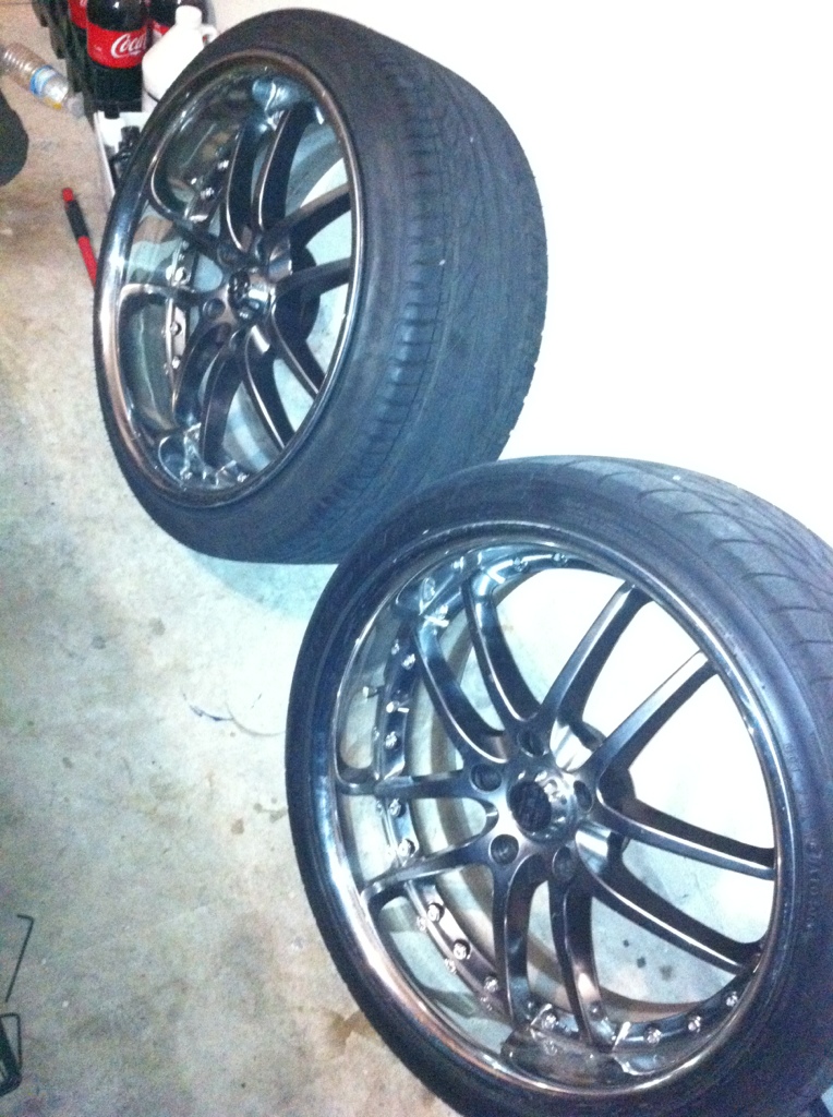

so i bought these's with tires for 500 bucks. there 20x10 r and 20x8.5 f wanted to put them on my g35 which i saw it says 5- 114.3 on one spoke and i tried to fit them it didnt line up . i checked the other spokes and one said 5-120 can these be redrilled to 5x114.3?
heres some pics

So one pair says 5x114.3 and one pair says 5x120?
These can't really be redrilled easily.

no see thats whats crazy , they says both patterns on each wheel

no the studs are off 3 fit more then less but 2 dont there half showing in the holes
Old Aug 13, 2012 | 01:58 PM
VMRWheels's Avatar
Joined: Jan 2012
Posts: 1,866
Likes: 105
From: Anaheim, CA
I believe the wheels are 5x120. A lot of wheels display various markings like this, and what I've heard is that the smaller bolt pattern basically indicates the smallest PCD that it could be drilled to by the manufacturer, in accordance to the center area. For instance, if the center cap area was smaller it may go down as far as 5x100.
Either way, if none of the holes are lining up the only option you have would be to run adapters or to redrill them. I don't see a reason why these couldn't be redrilled though.
