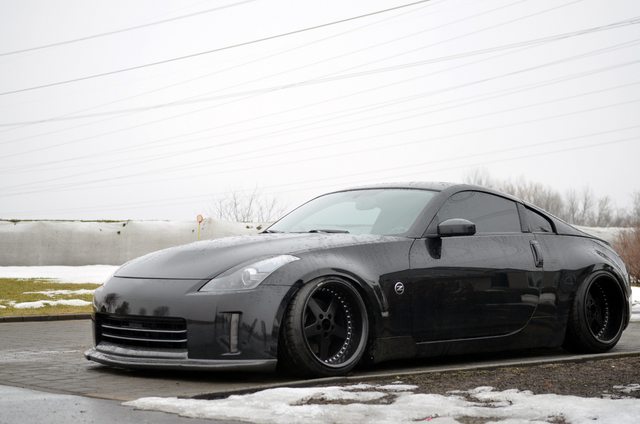

Im really impressed with Rota for coming out with such an agressive rim.
What do you guys think. I want to get 2 of them, because I have p45R2's, So I could get wide staggered rears.
The offset is 18x12 +20
What would I have to run camber / Tire Size to pull it off.

Well... the first pic is of Work Equips and the second is of a widebody so I'm not following what info you hope to glean from either of them....
But anyway - it'll partly depend on your ride height and fender work, even a roll will sometimes end up with a slight pull so it's going to vary from car to car. Best bet is get them, put them on the car, and measure where you're at for tires while you tweak the suspension to get whatever amount of tuck you're looking for. It's not super easy to run a 12 in back, very doable but you have to be careful about how much camber you're running. I think if you go over -5 or so you'll be cutting it close to the struts/coils. On the bright side, it's not so aggressive at +20 that you'll need that much camber, especially if you do a little fender work.
Long story short, they'll fit with some work, but how exactly will depend on you. Grab them and start measuring and playing with fenders and camber until you find what works for you.

Oh, Sorry, I just typed P45R3 into google images and posted the first 2 pictures i saw.
