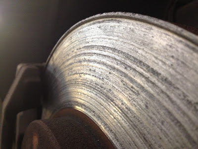

Wheel bearing...or brake issue.
These cars are notorius for seized rear calipers. The sit low on the rear wheels and moisture accumulates in the lower slide pin eventually siezing it. The caliper is locked in place and only the piston can push the inner pad against the rotor. The outer pad looks fine, and so does the outer rotor, but the inner pad wears down to the backing plate which then contacts the rotor. When this happens, it feels like a grinding motion.
This goes undetected because the visible part of the rotor looks normal, so everyone assumes their brakes are fine.
Inspect the insider part of the rotor for roughness and grooves like this
If you find this sort of wear on one side, then more than likely the caliper side pins have seized.
