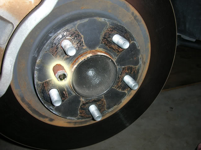

Ok, I understand now. Would you be able to show me a picture of that front fitment bolt? I wish I took a picture, now I can't remember exactly what I was looking at. It did not look like something I could take out.
Thank you

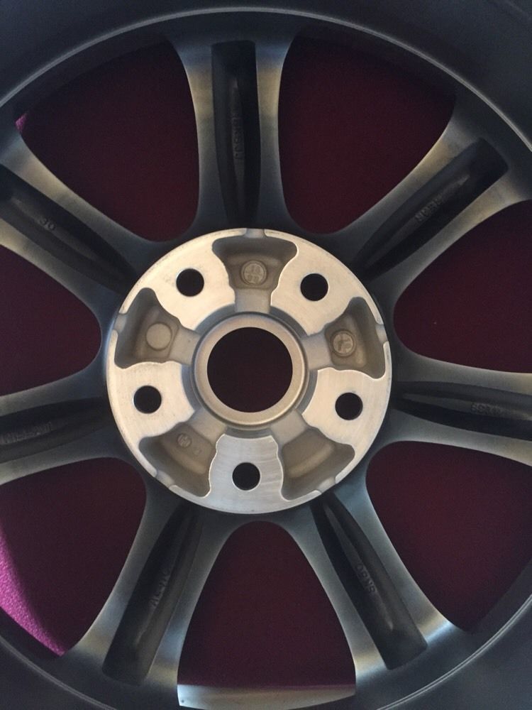

It looked like this: The center hole being "less" deep. Didn't look like a bolt to me

Ah, I think I understand. The bolt is on the hub itself. Could you describe to me what it looks like, or show me a picture, or possibly tell me how to remove it?
Thank you
Old Jul 19, 2015 | 03:03 PM
ScraggleRock's Avatar
Joined: Dec 2013
Posts: 6,811
Likes: 738
Just unscrew it.
