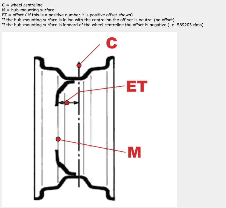

Originally Posted by BabySkyline
Thank you. I didn't see such bolt however, I would have known what to do with it. I did just notice that the center holes of one wheel was shallower, the other one deeper. As if one has a 30mm offset, the other one a 32mm, even though both wheels indicate a 30mm offset.
Am I going crazy?
ET is measured from the center of the wheel to the mounting surface, the depth of the holes around the mounting surface don't matter. The hole can be deep or shallow, but ET / offset is only measured from the flat surface that mounts right up to the hub.
Heck, those holes could be hollow and go all the way through the face of the wheel, wouldn't change ET.
