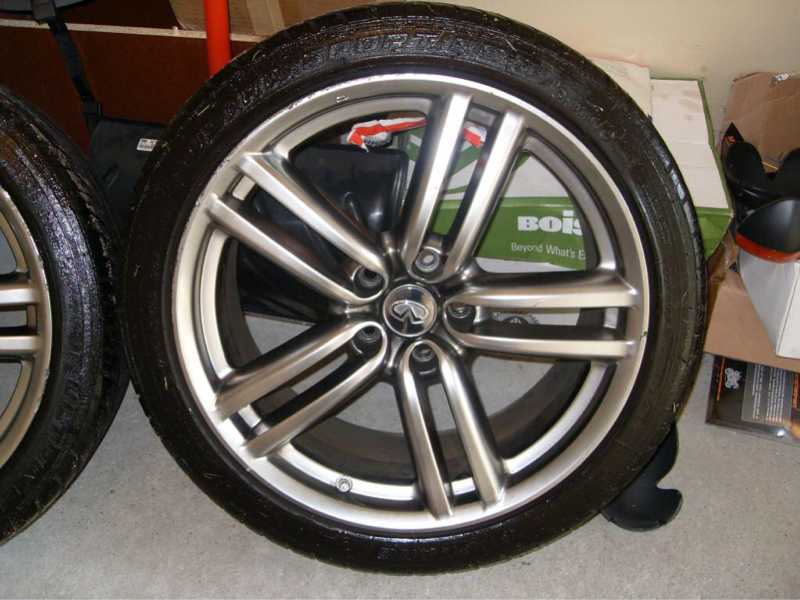

Hi, I was wondering are these m45 rims? if so how much can I sell them for I just picked them up not to long ago and they are currently what I am riding on. also how come it looks so much better on the sedan compared to my coupe?
I think the ones you have are also as well. Another variation of them

Yours are too if I'm not mistaken
Also the sedan looks better as the offsets on those wheels suit it better
You can try a small spacer out back

The M45 offset is +55, you would need mega spacers to get them off the suspension, much less get them flush. But, it's been done.

Stock offset for coupe is +15, M35 offset is +55. So to get the wheels to stock coupe offset, you would need 40mm spacers. If you wanted to get the "hellaflush" look, add 10-15 more to that.

Stock 19s offset actually +30/33,Tex
I see, my rear has 32mm and my front are 25mm I think dam I mind as well try to sell or trade these wheels lol
