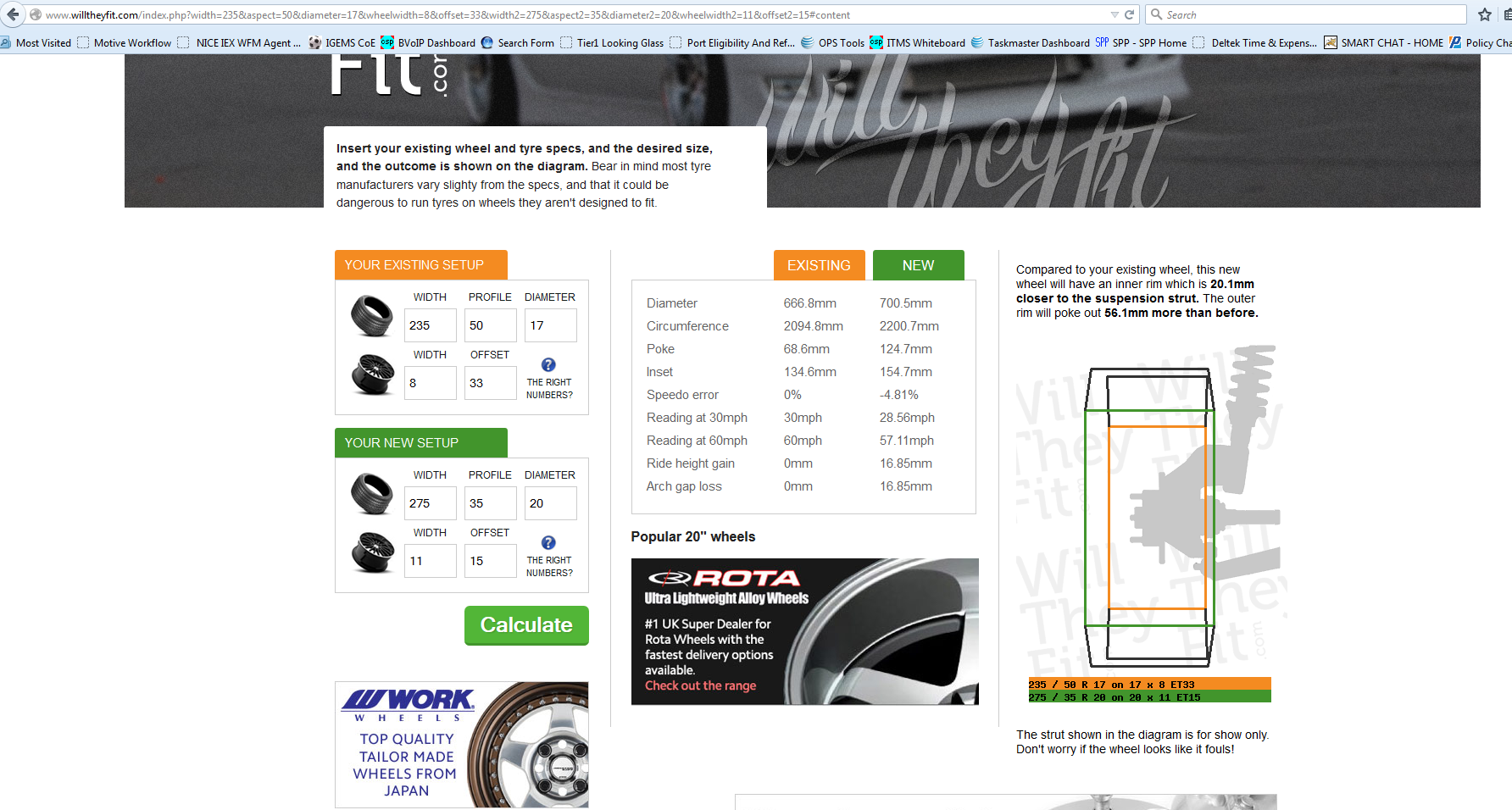

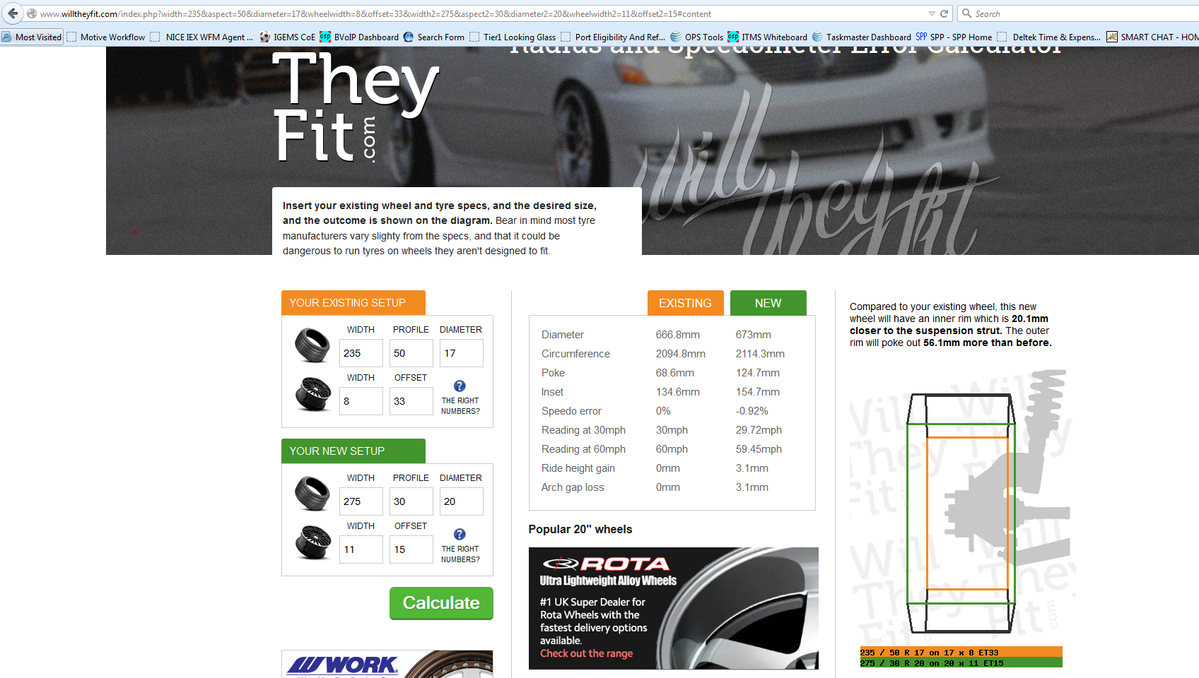

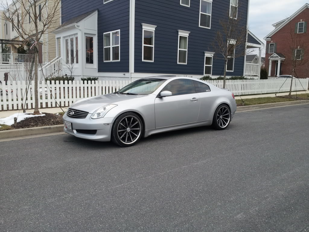

@LoSt180 I know you stated before to go ahead and go with the tire size on the rim that the original owner had which was 245/35/20 (20x9) F and 275/35/20 (20x11) R and that would give me a 3% difference in Rolling Diameter from OEM wheels. However my question arises is...
I've see a few people having the same question as me, but not the same answer given.
I've also seen a staggered set-up for tires for sale which are 245/35 and 275/30.
How would this affect Rolling Diameter? & would this be more ideal to work with (even with a tiny stretch).

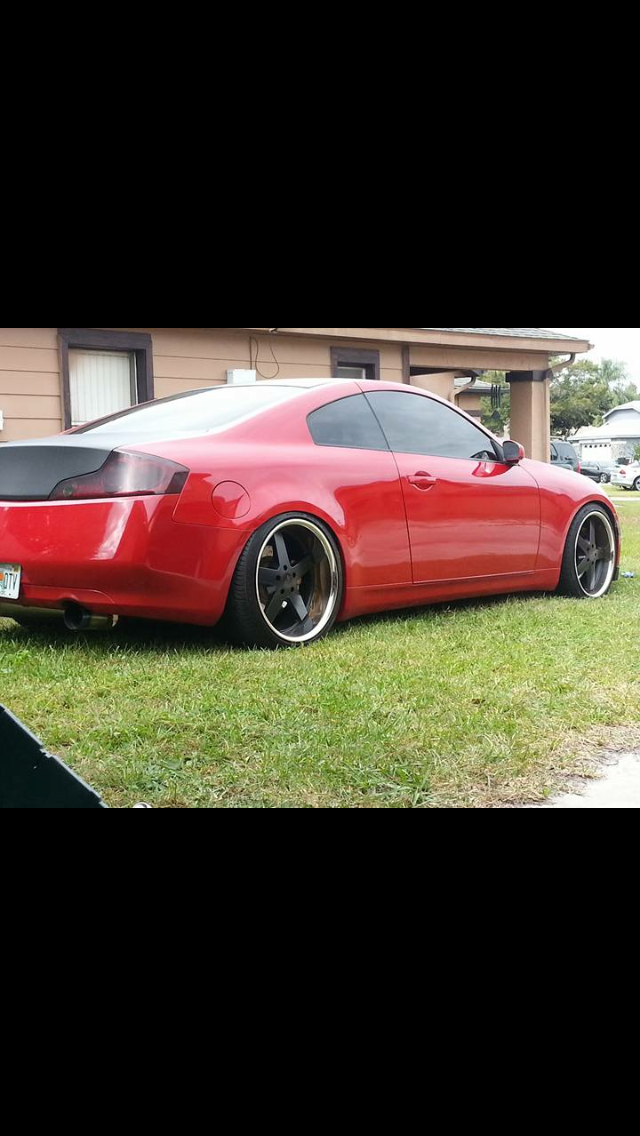

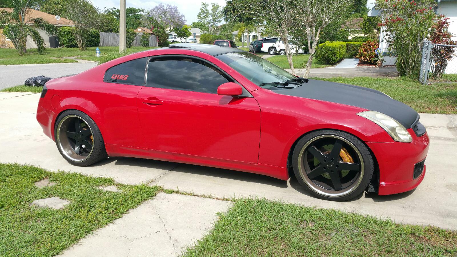

P.S......I've attached a 2 pictures of the original owner's G35 with the 245/35, 275/35 setup..all he said he experienced was he rubbed on big dips doing 75mph on a bumpy road mainly Downtown Orlando on I-4 (if anyone if familiar with the roads out their)

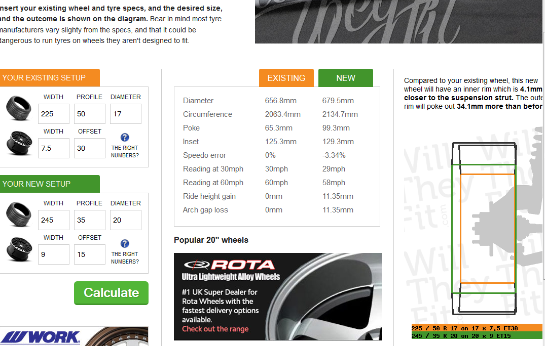

Just to add to this.
I compared my existing setup both fronts and rear on OEM specs and then compared to the potential specs of tires w/ offset.
I am just trying to come to the conclusion with rolling diameter to be closet to stock but I'm a bit confused.
Use 1010Tires tire calculator to figure out rolling diameter differences...make sure it's within a 3% difference.
http://www.1010tires.com/Tools/Tire-Size-Calculator

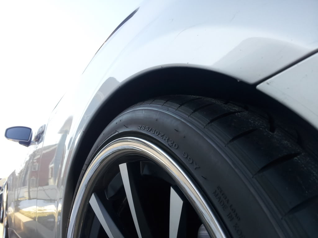

Since your doing that, from what it looks like in the pictures, the height of the vehicle changes, based on the sidewall of the tires?Originally Posted by LoSt180
Again, I run 245/35 & 285/30 on mine. This is essentially a square setup in regards to rolling diameter.
For example, your rear tires look smaller than the front. Is this due to the 245/35 and 285/30. The 35mm sidewall and the 30mm sidewall? Or did nothing really change because the 285 corrects this?
For example, wider tires = shorter sidewall?

35/30 isn't mm, it's a percentage of the width. ie: 35% of width is the sidewall height. For example, when comparing a 275/30 with a 285/30, the 285/30 will have a slightly higher sidewall since the "30" is actually a ratio (3.25" vs 3.37" to be specific).
245/35/20 and 285/30/20 actually have the same sidewall height of 3.4". That's probably a crappy pic due to shadows, and the rear has a little bit more of a "stretch" than the front tires.
To avoid screwing with the VDC, you want the overall tire diameter/circumference to have a LESS than 3% difference between the front and rear. Both 245/45/18 & 245/35/20 tires have the same diameter as a 285/30/20 tire. To the sensors, they're the same since they spin at the same speed.
Your lowering springs will have zero effect on this ratio.
