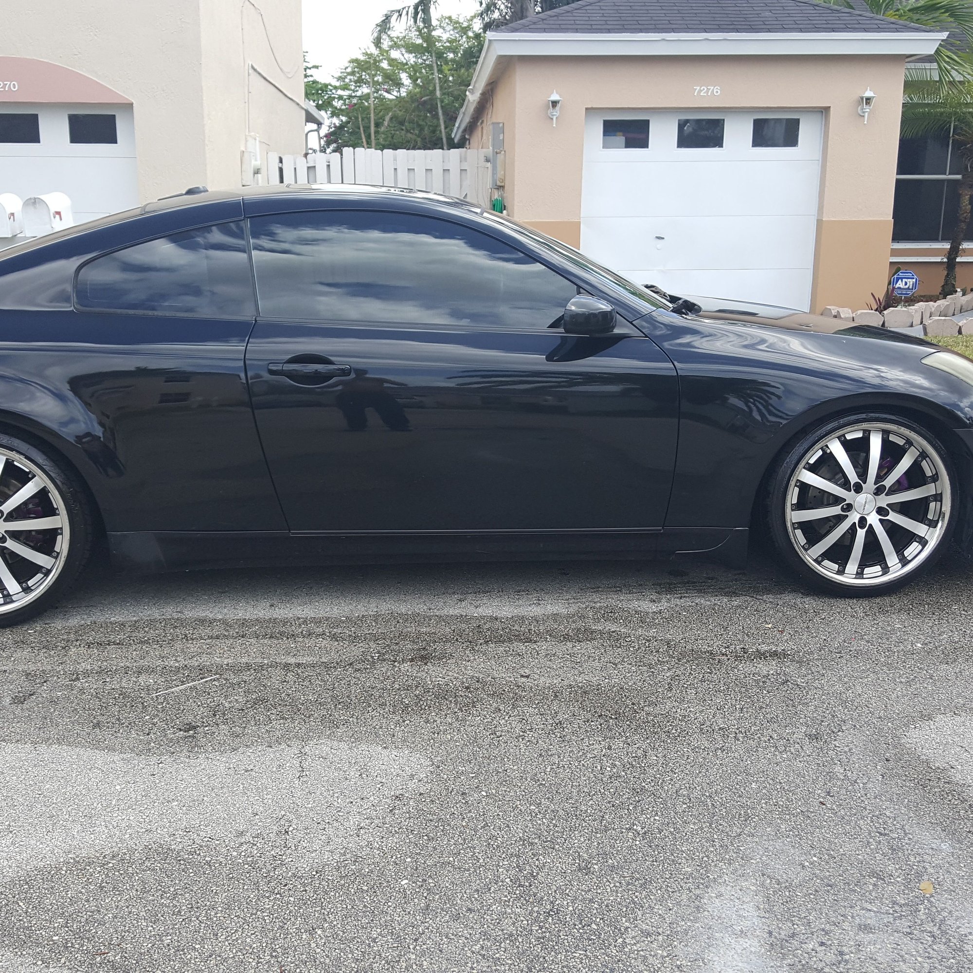

Lowered on Tein S-Techs
Old Mar 31, 2020 | 06:14 PM
Peninsula VQ's Avatar
Joined: Mar 2020
Posts: 5
Pretty much stock G. Mods coming soon.

did you need a camber kit with the s techs or have your tires been fine ?

You need a camber kit if you lower the vehicle AT ALL, there is no factory camber adjustment in the front thus why you add one.

I have 350z Nismo springs with no front camber kit and my front camber is -1.8 and -2 left and right after correcting toe, which is fine for the kind of driving I do in the G. The rear definitely needs toe bolts (that you sent me Cleric, thanks again!) installed because my Truhart camber arms that I hoped would do the trick aren't, forcing me to run slightly more toe in than I'd want to keep -1.5 rear camber.
That said, that's with like a .25" drop
