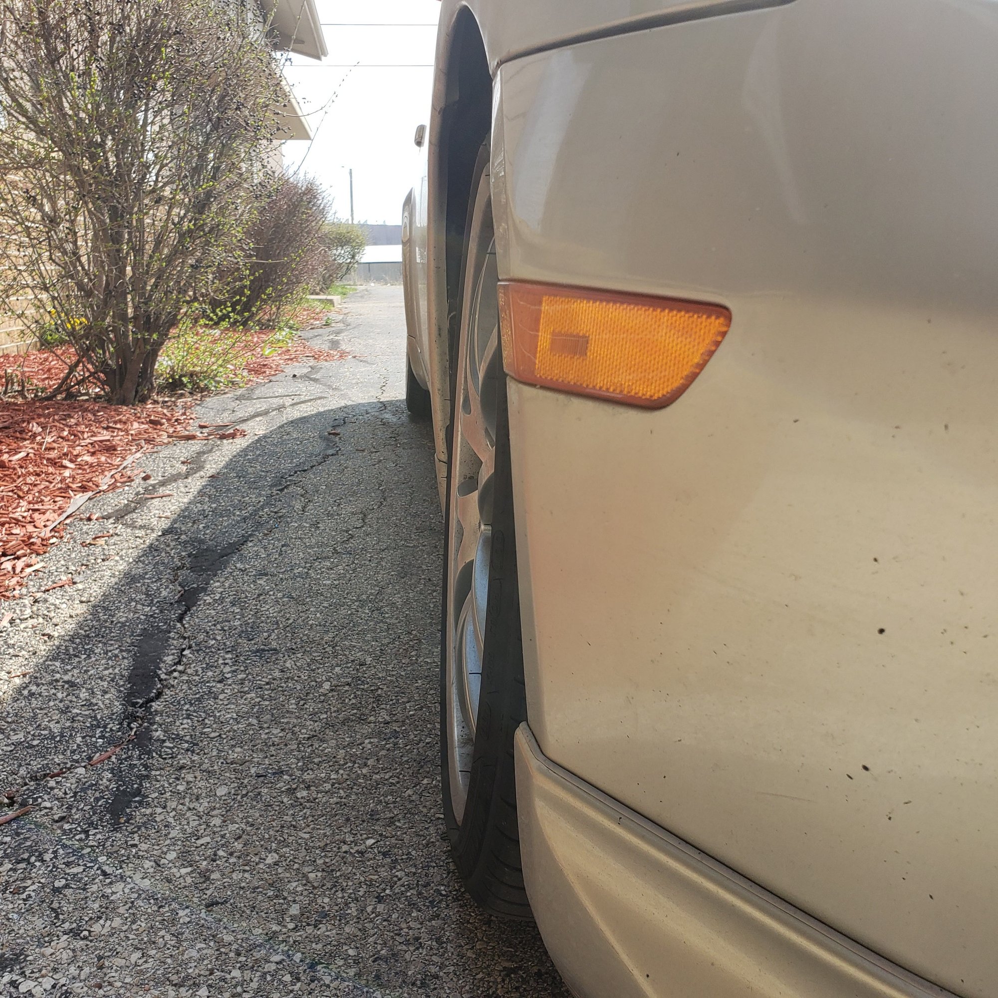

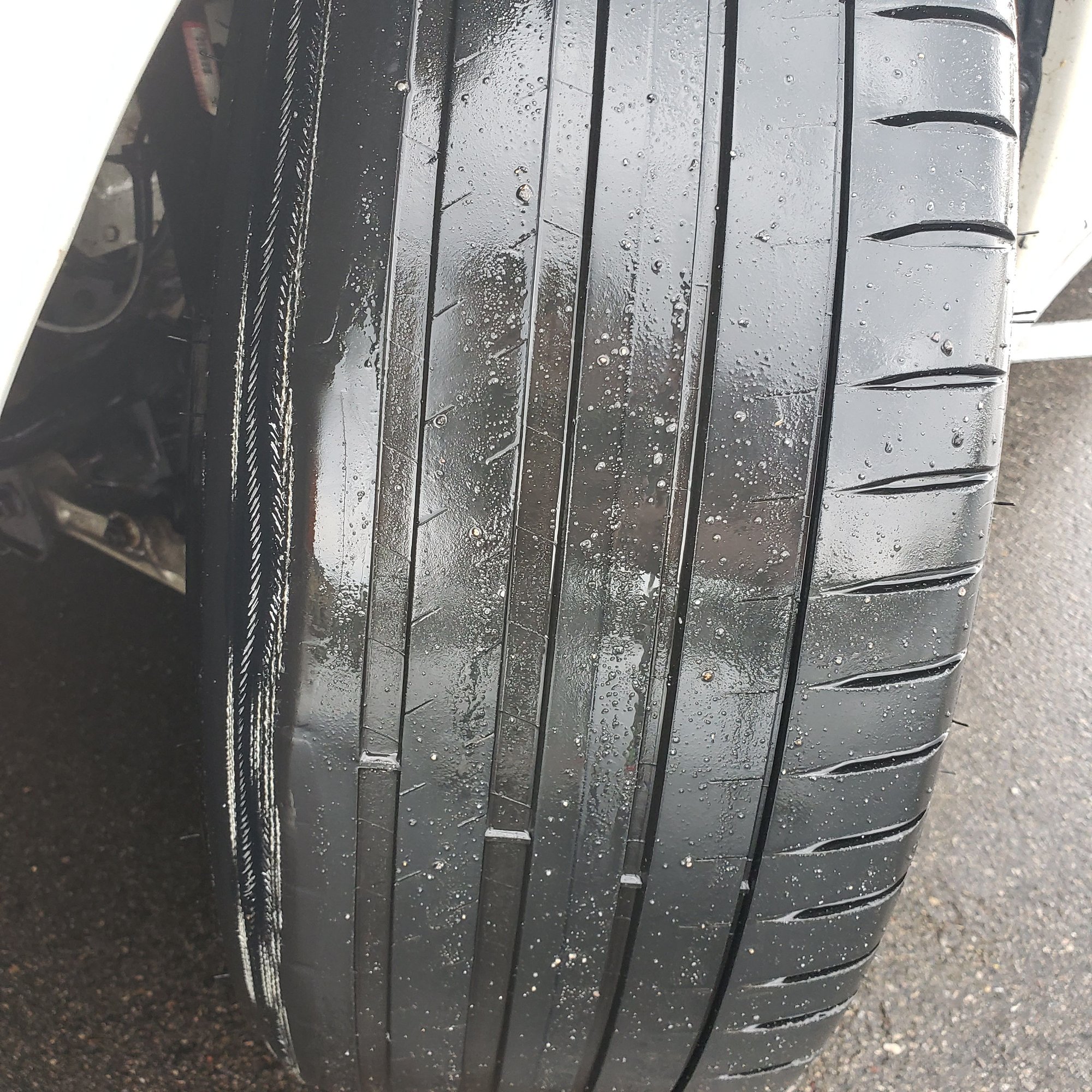

Hey guys so my 05 g35 coupe is stock suspension wise. I just put a brand new pair of Michelin Pilot Spot 4s on the front last summer and the insides are already showing wires while the outsides are fresh. I drove fall, winter, up till now on them (less than 1 full year).
Something to mention - car had 17" wheels stock, and I put the 19" Ray's on. Could this be the reason for the tire wear?
it doesn't even look like the camber is that dramatic, I know its set from the factory to be slightly angled for handling but this is pretty extreme tire wear. I thought my wheel bearing was bad until I saw the tires, extremely loud road noise and wonky handling starting to happen occasionally at highway speeds on uneven roads. I just replaced the passenger side upper control arm/ball joint but this has been happening it seems for a while.
here are some pics. My question is why are they wearing so fast if my suspension is stock, and will an alignment fix this or do I need to by a shim kit?
Camber is noticable but not extreme, should be stock specs
Tires are 1 season old

You need to replace your lower control arms ASAP. The wandering you're feeling is due to a blown bushing. I've circled the problem in the pic you posted. The arm should be centered, in this pic it's all the way to one side.
If you are completely stock, then it looks like you have excessive camber in the front. It should be -0.5 degrees in the front, and that pic looks closer to -2, something to be expected if the car was lowered.
Replace the lower control arms, as well as the compression rods. If you look them up on a parts website, they'll be called "front lower control arm - forward" and "front lower control arm - rearward". I'd do all four of them, plus the ball joints while you're in there.

Your camber looks drastically off for a stock suspension, like Lost180 said, something is likely broken/severly worn.

No camber adjustment on stock suspension. Tire wear like that on a narrow strip on the inside is from bad toe settings. Car may align fine, but if suspension is worn out, it won't hold. Replace worn parts, alignment, and new tires all at the same time, or you'll end up here at the end of summer with the same problem.
