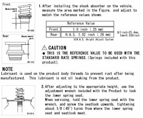

Adjusting height on basics changes the spring preload in the front, so the ride may suffer if you deviate from the recommended too much. Compressing the spring lowers it, so the ride gets stiffer. Loosening the spring raises it, so you may get a softer ride and clunking if you loosen it off too much.
I got the Flex, you can adjust height without changing the spring preload:
Flex:
Basics:
