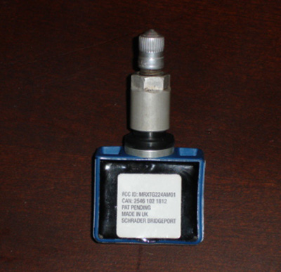

Originally Posted by Poptarts
are u sure on this? how does it measure pressure in the tire itself? the wheel/tire is rotating and the sensors arent in the wheels. if your pressure drops below a certain point ir ride height in that area will be affected thus setting off the low tire pressure sensor. i could be completely wrong but this has always been my understanding
^^ Like Chico said. Here is a pic of a sensor that is mounted in the wheel.
Hmmm that's interesting. Made in the UK?
