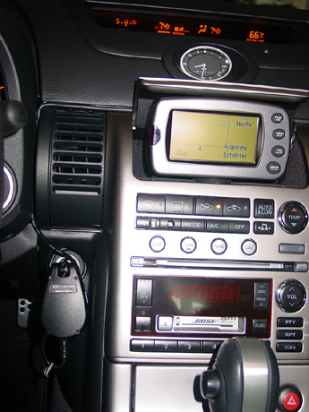

Model 2650, $460 at www.buyeretail.com but I think they sold out.
You might do a internet search if interested. These are great models.
Garmin will still honor the 2610 and 2650 units even though they don't produce them anymore.

I am sure many of us would agree with your approach. I did have navigation in an Acura, because it is one of the best available, built-in. But the better after-market navs can beat almost anything put out by auto manufacturers, as far as function, if not fit or form. They are more cost-effective.
I can not imgaine selling my Nav with my car, nor would I try to build it in.
It is just resting there nicely, and running off aux power. Plus it has the advantage of portability.
The 'hit' I take on resale for not having Navi on my particular car will be negligible as time and technology move on IMO.
