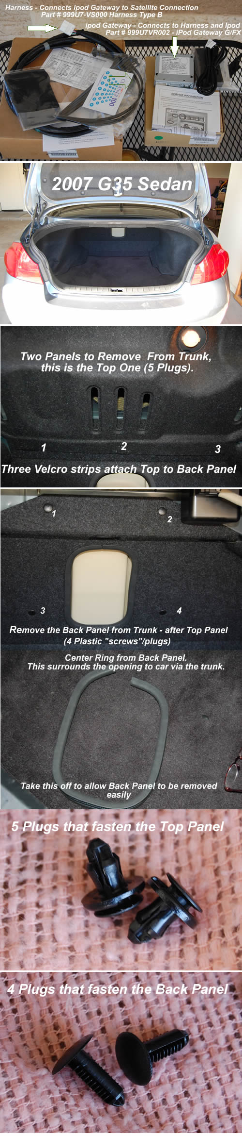

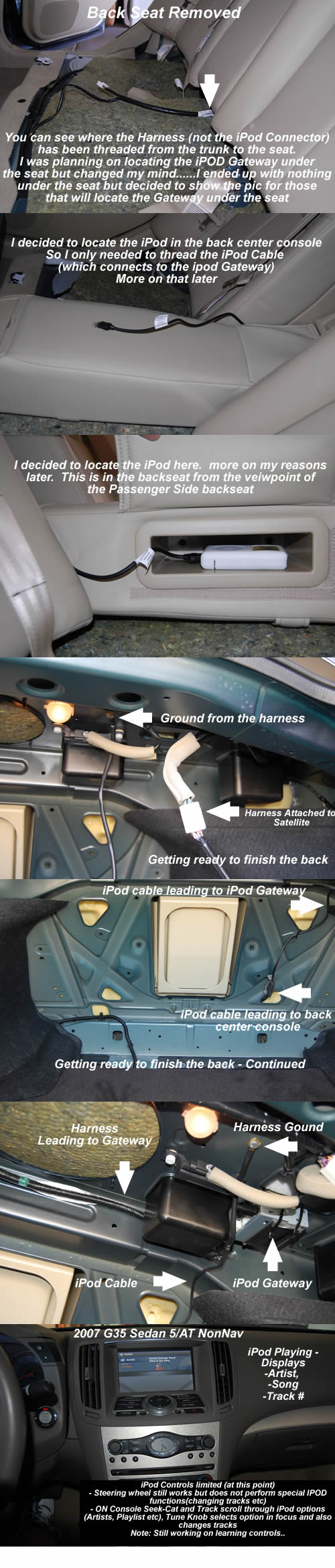

As a follow-up to my previous thread entry. Here is how I installed my kit in my 2007 G35 Sedan (non-nav and no Satellite tuner installed)
My iPod Factory Integration Coupe/Sedan [999U7-IPOD] kit arrived at 10:30 am today (Wednesday). The parts I got in the package were the iPod Gateway (999U7VR002), Harness Type B(999U7-VS000). I received this package from everythingg35.com ( a online merchant that is part of Infiniti of Scottsdale).
I excitedly opened the package and found that a bunch of stuff was missing (iPod Cable, Various Manuals, clips, grommet, padding and adhesive and other things like that). I called customer services, they apologized and said they would resend it. Since I was a local customer I drove the few miles to pick it up and was good to go…..
The images that follow will hopefully explain the process. However here is a step by step description…NOTE: This is shared simply to share my process and NOT as a educated tutorial on installing components….caveat emptor (buyer beware)
Steps
1) Remove from trunk – Top Panel (Don’t know the proper name but that is what I call it)
2) Remove from trunk – Back Panel (blah blah blah…see above)
3) Locate Satellite Harness – Pre installed on 2007 Models….Don’t know about others. Location is different than 2005 I know
4) Disconnect Car Battery (negative post)
(following done in trunk with no attaching to car…just to test..see pictures)
5) Connect Harness to iPod Gateway, Satellite Harness
6) Connect Harness Ground to….frame of car (used existing hole and bolt I had in the garage..save bolt for permanent use later)
7) Connect iPod Cable to iPod Gateway
8) Connect iPod
9) Reconnect Car Battery
10) Test iPod.
It works…Did not spend much time playing with controls only making sure that it worked
Now I need to permanently install so
11) Remove Backseat
12) I was going to install the iPod in the Center Console but changed my mind. I decided to locate the iPod in the center console in the backseat. The reasons A) Running the cable under the carpet was too much work, B) I did not want to cut into the backseats foam to locate the iPod Gateway (I don’t lease the G35, I purchased it, but if I was leasing I would not want to cut and drill the interior), C) The little cubby hole in the back center console is unused and good size to hold an iPod etc., D) Planning for future expectations (maybe a more advanced iPod integration system with the 2007 G35 is forthcoming…hint hint....heck rather than an iPod a USB Hard Drive is a better option) and E) It was less pain/work to install if I did not cut or dig under the carpet to thread the iPod cable. My rear center console is always up so the cable is NOT seen and even when it is down the cable is not really visible or obtrusive.
13) Mount iPod Gateway and tie down all cables etc.
14) Put Seat, Panels and everything back in reverse order
Anyway here are the pics….......you are probably asking how long this took. It took a total of 6 hours (1 hour taking pictures, 2 hours editing the pictures and writing this diatribe, and oh yeah about 3 hours on the install….which consisted of 1 hour cleaning up the zip ties etc (pretty **** about cable management and that stuff), and about 30 minutes to decide on another install option so only about 1 ½ hours of actual install work)
If you cannot see the pictures clearly (you may have to zoom in your browser or program that views images. The images are a width of 500 pixels so they are clear) send me an email and I will send them to you directly....
Attached Thumbnails Factory iPod Integration Successful...-1-7.jpg   Factory iPod Integration Successful...-8-14.jpg   Factory iPod Integration Successful...-15-21.jpg
