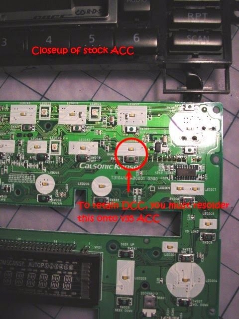

Anyone know where you can pick up a little green button thingy from the control board instead of having to re-solder the old one off the existing control board?
Old Feb 19, 2015 | 04:24 PM
  #94
Wrathernaut's Avatar
Gentle Manne of Leisure
Posts: 8,003
Likes: 1,050
From: Pennsylvania
It's simply a momentary contact switch, so if you get one with the same footprint and button travel, it'll work. I can do measurements on an 05/06 button, but I don't have an 03/04 to measure for you if that's what you're looking for.

Climate/Radio Control Board:
JDM Climate Control Board:

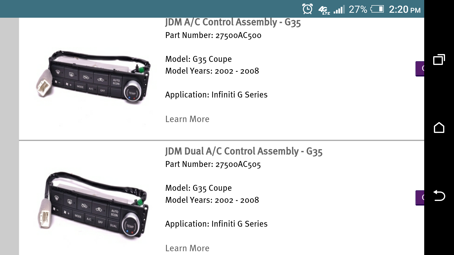

So I'm guessing both orange "bars" that define which side you're adjusting temp for will both be illuminated. I thought oem dual was 05-07 and oem single was 03-04. But this picture they both look the same, and both say all years .

They are absolutely not the same for all years. Those are the 05-07 coupe 05-06 sedan climate controls.
Dual zone wasn't an option in the JDM 03/04 cars, so unless you're buying a pre-modified one, you have to add the button back yourself (or ship it to somebody who can modify it for you).
Part #s are found in the first post of the DDin shopping list: https://g35driver.com/forums/audio-v...urce-list.html
