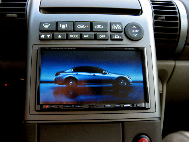

Do you have any pics of your install? I just bought a ddx-6019 off ebay yesterday....

-1st photo is the tuner
-2nd photo / playing jpgs not a wallpaper. the lame thing about this unit is they have 6 really cheesy, i mean cheesy, wallpapers (pokadots etc...). but the cool thing is, you can have your jpg photos loop while listening to the tuner/ipod etc.
i just have the ipod hookup, next thing i'll get is the navi (need to save some cash up)
