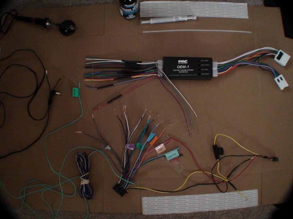

Thank you all for valuable info! I decided to give it a try with ROEM-NIS2 and I could not be happier. There is no distortion anymore on high levels, it almost worked like an amp and my Bose sub started to shake the entire car after installing this device. Before my sub was barely working and all I heard was distortion on high levels, it really worked!!! Got it for about $40 from Amazon and well worth it.
I am still planning to replace the entire system with new speakers and amp but at least that project can wait a little now. Time to go with a few more performance upgrades instead...

zeyn83, did you keep the 70-7550 harness, or did you swap out to the one made for Bose when you installed the ROEM-NIS2.
Posting up pictures of the install would probably be helpful as well, since there's a lot of people picking up used G35s and hitting up the a/v forum as of late.

ROEM-NIS2 installation
Yeah, me too... A $40 device saved me spending 1K for now lol. I contacted to PAC tech support and they told me that it should work better than a regular harness on any G35 or 350Z with Bose factory system no matter what year the car is. So all it does is as we discussed before it adjusts a good balance between the new HU and Bose amp and fix distortion...
I did not keep the Metra harness, all I have is the ROEM-NIS2 between the HU and Amp now and no reason to keep the Metra harness. I am posting a few pictures, it may be helpful for those planning to install this awesome device. Thank you all once again! I will keep you posted if I replace anything else on my system.
Attached Thumbnails Installed AVIC Z110BT and am getting distortion in the speakers-pac1.jpg   Installed AVIC Z110BT and am getting distortion in the speakers-pac2.jpg

^ You just built a Metra 70-7551 wiring harness out of a Metra 70-7550 wiring harness. They cost they same.
Some of the factory Bose amps have worked with aftermarket HUs just fine, but typically, the output from the RCAs isn't enough for the Bose amp to send the signal further forward.
