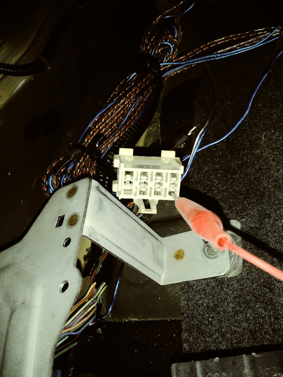

So I've replaced the headunit with a metrakit + double din radio.. All worked perfectly.. Until my brand new battery died multiple time overnight.. So i ran a troubleshooting:
1- removed radio fuse.. Car start ok in the morning no more battery drain
2- unplugged the new double din radio
3- check currrent draw with a multimeter
4- radio circuit has a 1.5A draw.. Believe its very high
5- unppluged the white harness power cable from the bose amp.. = no more current draw..
since the double din radio was completely unplugged i know that its not an issue with my wiring..
Do you guys know why the amp draw that much current when plugged in and how to fix it please !!
Thank you

Sounds like your amp is failing and drawing too much power. I believe that's a typical failure mode for the Bose amps.

Ok , so i found that the yellow / red cable plugged to harness is responsible for the 1.5amp draw.. But its only drawing current when the amp touched the metal structure on the picture...
Old Nov 25, 2018 | 07:48 AM
  #66
Scorpi0's Avatar
Joined: Feb 2018
Posts: 3,087
Likes: 445
From: LA, Cali
Because the amp is grounded to the frame of the car.
Seems like your amplifier is messed up. Either get a new amplifier or build a simple relay circuit to cut the power to the amp.
