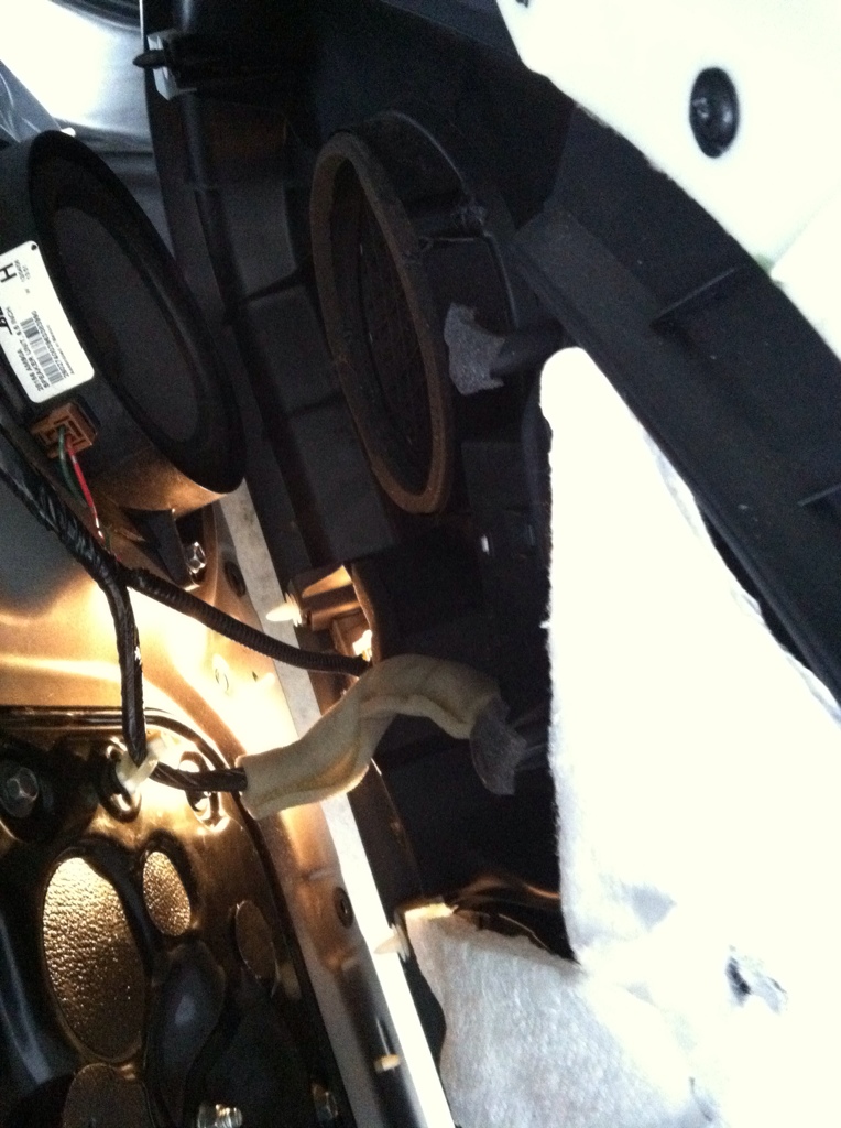

Not really. Cninham is talking about there being a gap between the aftermarket speaker and the the door panel.
So covering the "entire area" with dynomat would be an ineffective solution unless you're going to layer 3/4" of it to fill the gap..

Top Teke -- thanks for the pic and explanation. That is exactly what I had in mind to "remedy" the issue and close the gap between the speaker and the door trim panel.
By the way, do you know what thickness the foam take was? I got several different thicknesses and densities -- e.g. the low density black foam (bigger "air bubble" in the foam) and the higher density white foam, with the adhesive backing, from Home Depot.

I went with the 3/4"w 1/4" thick stripping for the ring barriers but it was a little too dense. For the gap I cut a strip in half lengthwise (so 3/8"w).
If I did it over again I'd get the black one you mention for baffle purposes and then the higher density one for the gap issue.

Top Teke -- in your picture of the original speaker in the door panel I see you have some white "soundproofing" mat. What is that and where did you get it? It looks like the heat-shield/cover that one puts over a dish-washing machine...? I was thinking of using carpet padding for the door panel and rear seat side panel as a cheap alternative for soundproofing. Otherwise I was thinking of using the paper backed fiberglass insulation (e.g. "Think Pink"). Also, I notice that Home Depot is selling memory foam under-carpet padding: 10 lb. density and 3/8" thickness which might work nice, but be a little heavy.
Old Apr 19, 2012 | 02:20 PM
Top Teke's Avatar
Posts: 335
Likes: 22
From: Big Island
I believe that's actually just the factory sound baffling, however I am the 2nd owner of this car so it's possible that it was added. I just found out that somebody had the tint removed before I purchased it so it wouldn't be the first surprise.
If the carpet padding isn't too heavy that's probably what I'd go with though.
