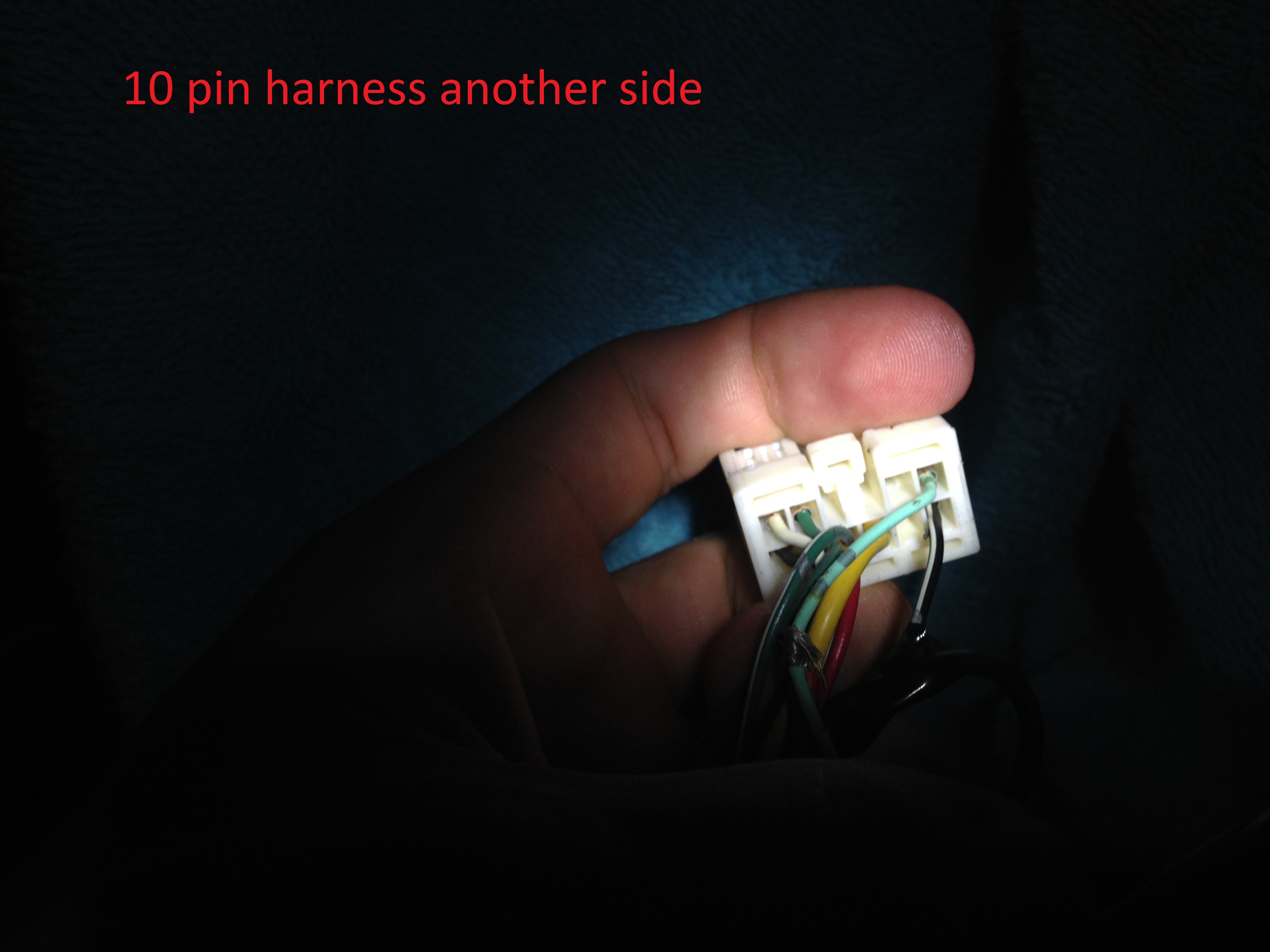

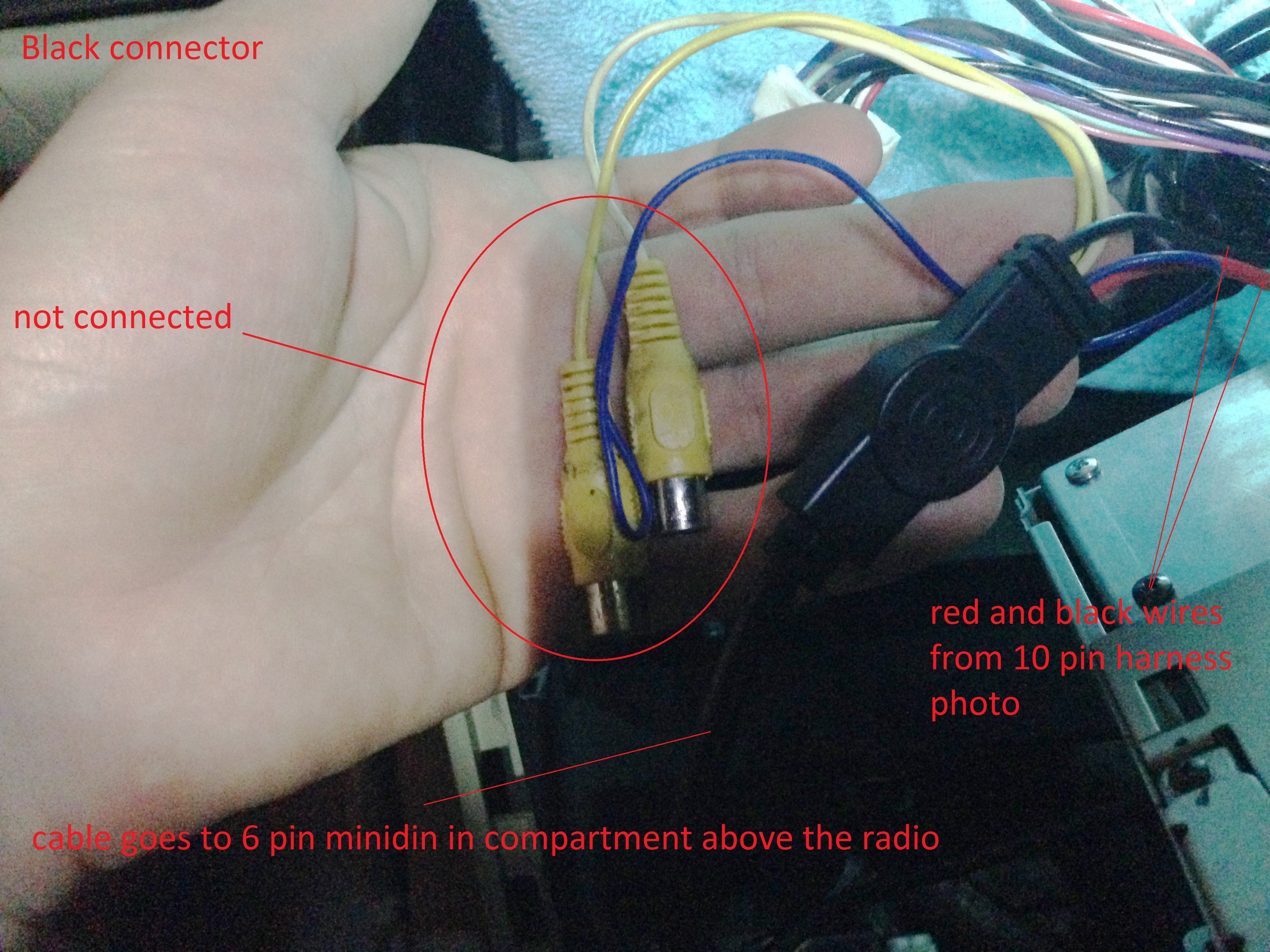

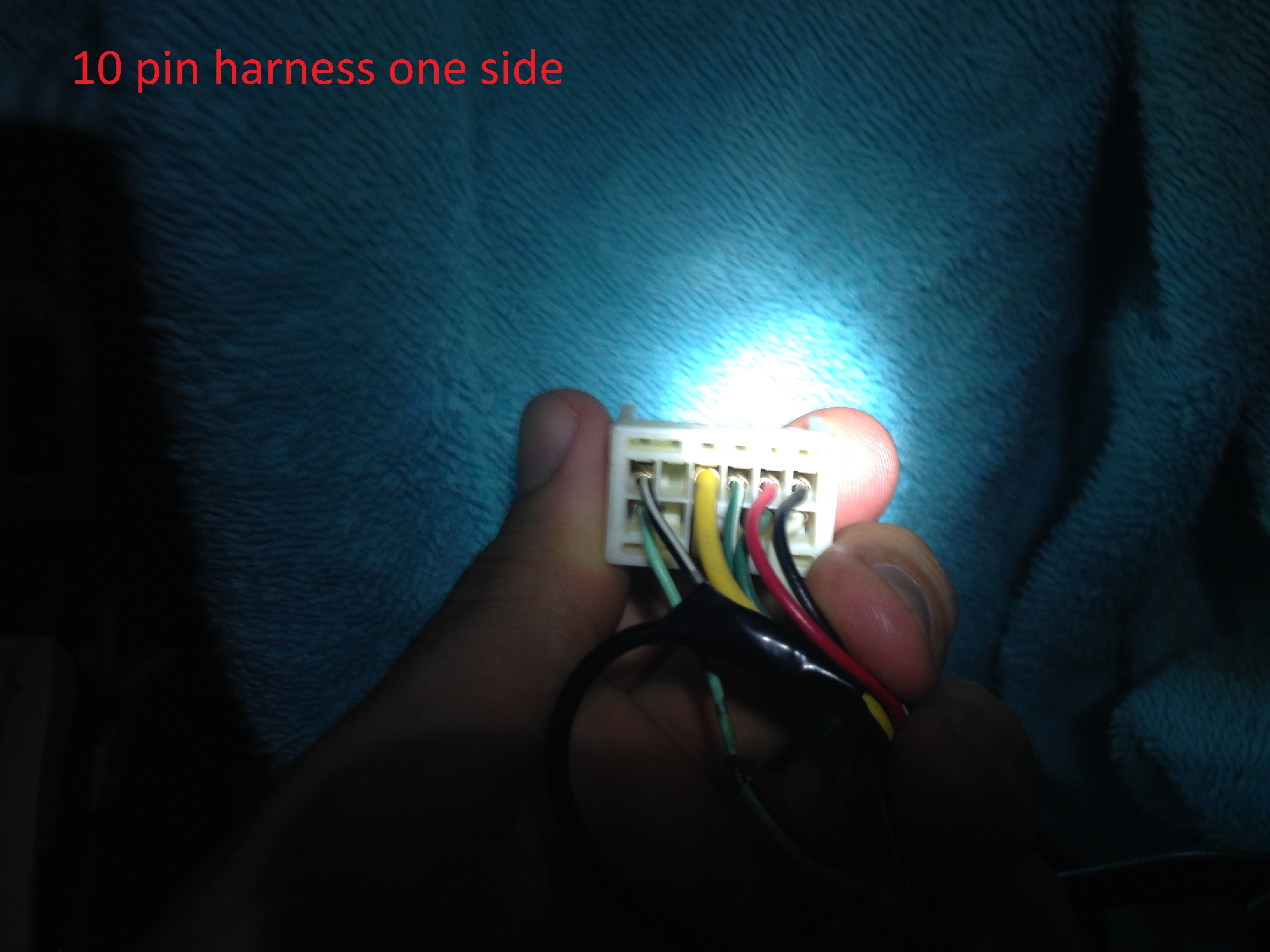

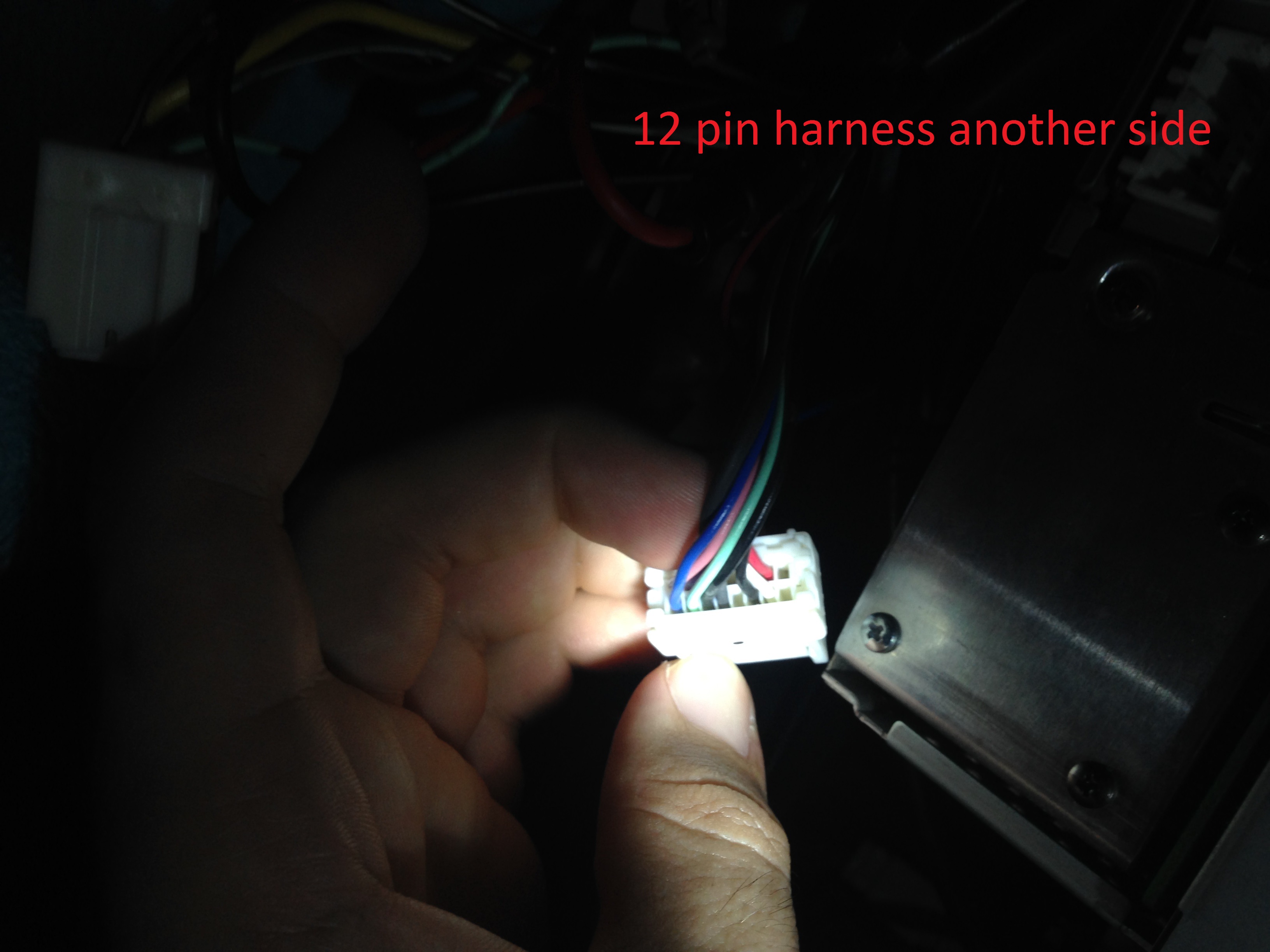

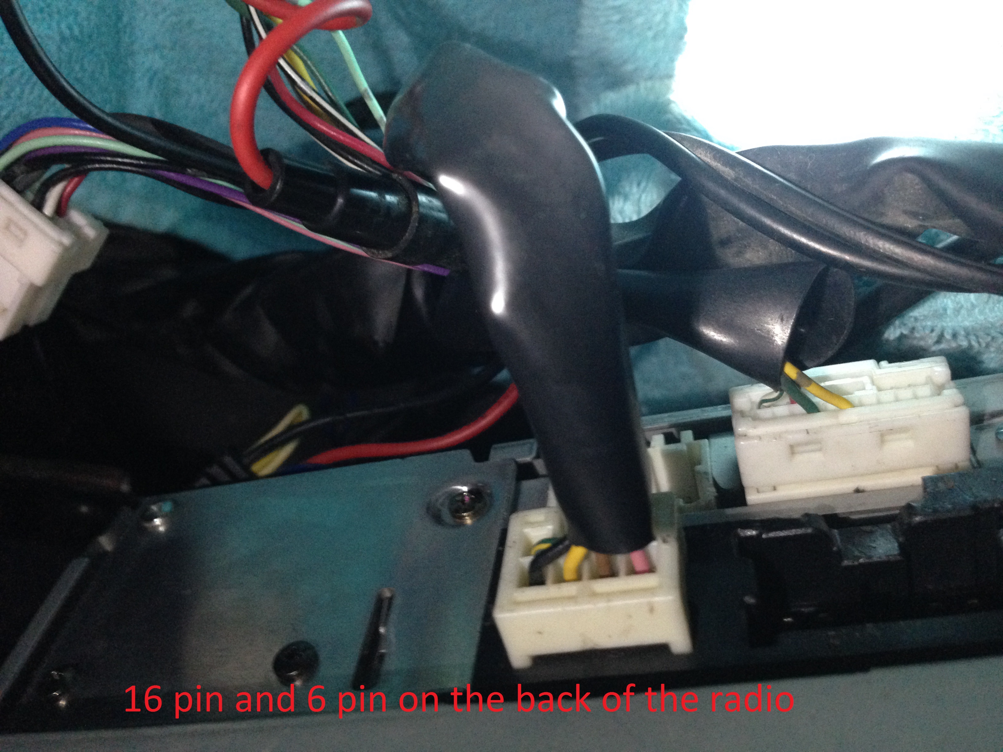

I have purchased ISNI571 and got it here yesterday.

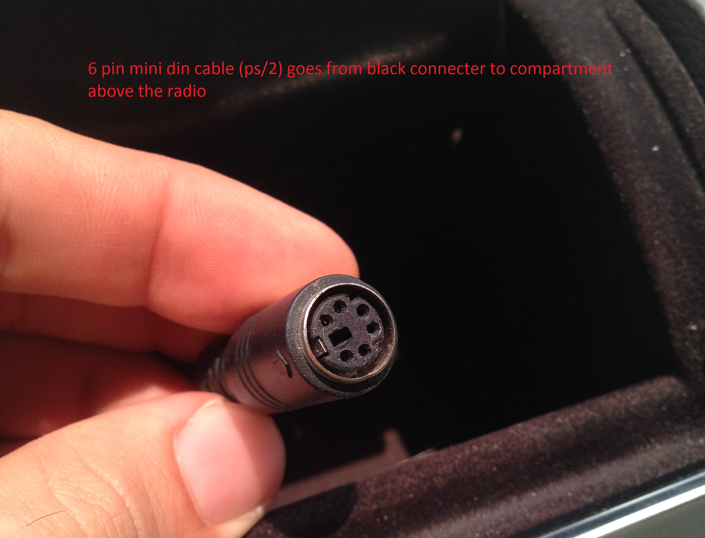

I removed the radio and completed all the steps as per installation manual. However the radio was not able to change to XM mode and I probably know the reason.
As you remember, there is some box in the trunk (bluetooth adapter) and mess of the wires. By the way, I have never used this bluetooth, because the display of control device does not work properly.
There is the same situation on the back of the radio, it looks like wires from some of the harnesses were manually changed. I have attached the pictures with my comments.
Also there is the 6 pin minidin socket in the central console above the radio, but I don't have any idea what is it. And there are two yellow sockets on the picture, they look like RCA.
So now I have to restore original factory wiring in the harnesses and then connect ISNI571 adapter and try again. Can you please advise me factory wiring? My car is g35 2006.
I wish I could find somebody who understands this well. But here in Emirates it is very difficult, so I have to cope with this..
In the manual it was written to remove the antenna connection from the back of the radio, but I didn't do this. Is that really required?
Looking forward to your help!

Originally Posted by uNwar
Thanks, Wrathernaut, I really need good luck, however the situation is not fruitful now..
Wow, that's quite a hack-job there. They couldn't even be bothered to get properly-colored RCA cables.
The factory service manual can be found at psedog's repository: http://psedog.com/cars/fsm/g35/coupe/2006/av.pdf

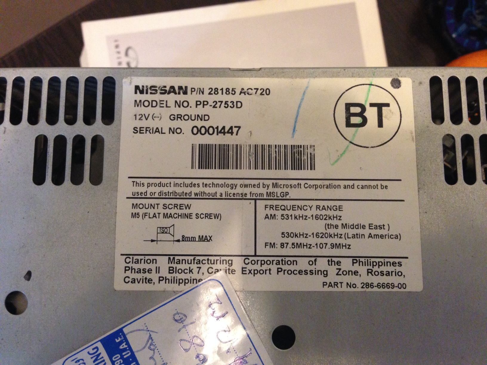

I have removed the radio and cd-changer. I have found sticker there with model no and frequency range. The frequency range does not show XM, there are only AM and FM. I have attached the photo. I cannot believe that this radio does not support satellite mode!
Do US spec radios have XM range there?
Any ideas how to make this adapter work? Does it support cd-changer emulation mode?
No, the radios don't have XM range themselves at all. The XM/sirius adapter receives the satellite frequencies and sends an analog audio signal to the radio. Not sure if it's full cd-changer emulation.
