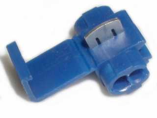

Arrow Splice
More than likely it is a weak connection to the factory wiring. If the installer used inline splices like the one in the photo there is a high probability that the clamp did not 1) penetrate the factory wiring shield or 2) the added wire to the remote start system is not making contact with the splice. This is a relatively simple fix.
The installer should be able to identify, based on the symptoms, which wire is at fault and should have it corrected within 20 mins, if that. I have used many of these on my audio installs and it wouldn't surprise me if they did the same here as it leaves the factory wiring intact without cutting and splicing the old school way. Hope this helps a bit...

If the installer used the above style crimp you should find a different installer!
The first question to answer is how are the doors interfaced? Are they hard wired in to the doors (doubtful), did they do the BCM "empty pin" trick (possible), or did they use a data module (probable).
The solution to the problem will depend on the method used to control the door locks.

Those crimps cut into the factory wiring, and may damage the wiring inside. They usually give a fair connection, but soldering is the only connection method that I'd expect any professional to use. Yeah, you give up about 1/4 of an inch of the original wire, but it's easily reversible by re-soldering the old wires back together.

You shouldn't give up any of the factory wiring if done right. The wire should never but cut. Strip a little back, wrap the new wire, solder it, and tape it. If you ever want to take out the added wire you can just peel the tape back, cut the added wire, then tape it back up. Always use a high quality electrical tape (I will ONLY use Scotch 33+) and you should never have any problems.
I can't even count how many issues I have personally seen resolved by switching from TTaps or Scotchlocks to soldering.
