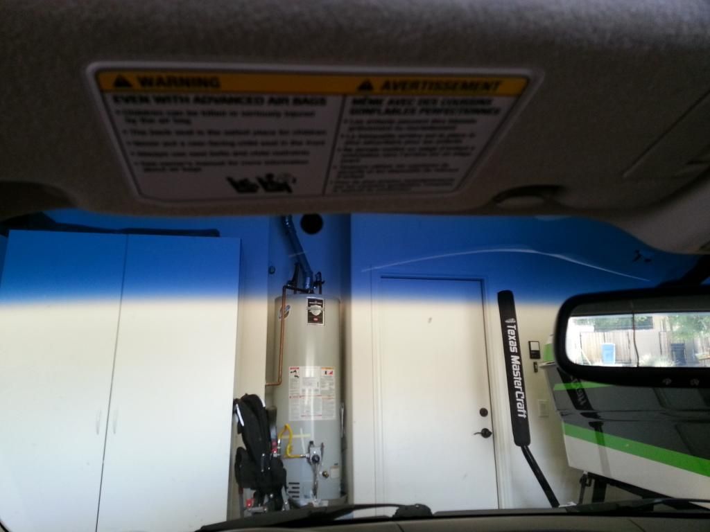

I was able to get everything put back together this past weekend. I ended up mounting the mic just behind the sun visor. This position provided the best audio quality of the places I tried. It is far enough back that I can still fold the sun visor down without hitting the mic. Here are pics of the placement.

After using the new mic for several weeks I haven't had anyone complain about not being able to understand me or that my voice is cutting out. Thanks for the input provided in this thread.
