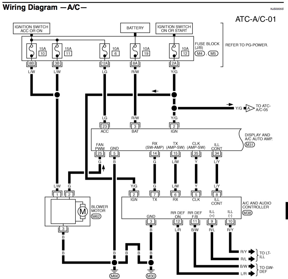

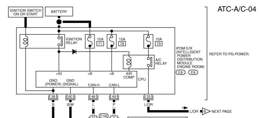

Can't answer about the condenser but you could easily disconnect the compressor in the meantime.
Here are wiring pics from '05/'06. Many fuses involved so not sure which runs the display or what else they may run.
Good luck.
Attached Thumbnails Fuse for center display?-acfuses1.jpg   Fuse for center display?-acfuses2.jpg
