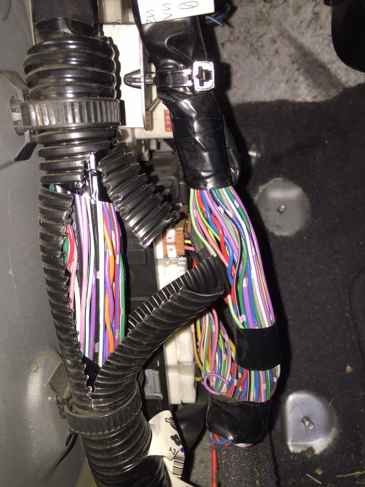

Which purple wire am I tapping into?
The purple ones in the left bundle of wires(in the plastic tube) have some silver spots/circles on them, and the wires on the right have spots on them as well, but one is solid. I doubt it's on the right side wires because in Wrathernauts guide it was a purple wire in the left tube. Help?
http://imgur.com/f75hG70
Look carefully at the picture Wrathernauts posted: The harness he is pulling the purple wire from has the white tag with the number 24014. THAT is the harness you will be pulling from
If you have a coupe, it's the purple wire. If you have a sedan, it's the orange wire.
Okay, so I'm looking at the same harness with that white tag, but there are about 3 purple wires in there (with those silver markings). I guess I might have to just put the car in reverse and test which one of the three is the true Reverse wire with a multimeter.
It should be the solid purple wire. Since I have a sedan, mine was the solid orange color. The link I referred to said purple. The guy that wrote the thread would have indicated what markings the wire had, if any. Don't over complicate this, KISS.

Keep looking in the left wiring bundle. It's solid purple w/no markings. It's in there.
Looked again and, for the life of me, I STILL could not locate any solid purple wire. Four purple wires marked with a silver sharpie(or whatever the factory used)...
Could I just run a wire from the headunit straight to the rear tail lights where I already have the cam's power wire connected?

Originally Posted by cninham
PART 1
I switched my back-up light "sensing" wire from the one in the TCM harness behind the kick panel on the passenger side to the purple wire behind the kick panel on the driver's side.
See attached pictures:
so i found this post and it seemed super definite. but now i am even more convinced this wire doesnt exist for me. for my 06 6mt coupe, the slot in the B41 connector is blank...
