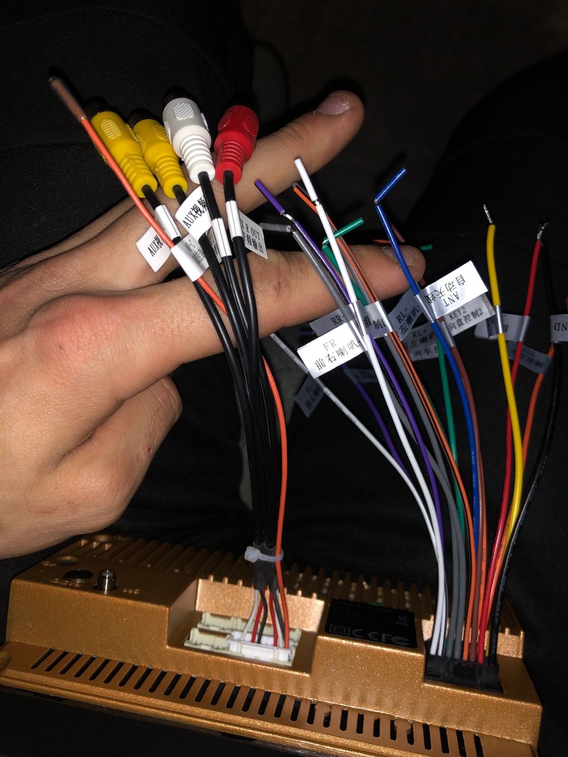

Can someone help me. I just bought a double din what harness do I need to get the steering wheel controls to work and a harness to work with bose amp.
Bought this.
This is what comes with the din

Yup...the Metra 70-7551 is the correct harness to hook up the stereo.
U will also need a Metra 40-NI10 antenna adapter to hook up the anyenna cable.
For the steering wheel controls, either a Metra ASWC-1 or a PAC unit.
I think u will find the following thread very useful: https://g35driver.com/forums/audio-v...urce-list.html

Pac
This also came with the double din kit. What’s it used for

Nice. Thats exactly what u need. U use that to install a new head unit into ur car. It works well with the BOSE audio system.
See thread: https://g35driver.com/forums/audio-v...peakers-4.html

What do I do with the rcas the pac doesn’t have connections for it

Hmm...Im not too sure if those need to be hooked up to the Bose amp somehow.
Send a message to member Wrathernaut. Im pretty sure he knows.
