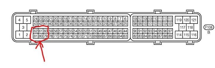

First thing you should do before tearing the tranny off is verify the coil pack wires are actually connected to what they're supposed to be connected to.
Each coil pack has a black wire, it should have continuity to ground. To test this take a digital multimeter and turn it to OHMS (horseshoe shape) on something like the 200 range. Now touch the two leads together and watch the meter, it will display 0 or 1, this means it's a continuous circuit, that's what you want to see when you put one lead on each harness black wire and the other lead onto the negative battery cable.
If you DO NOT have ground then something isn't plugged in somewhere, start with the two primary coil pack harnesses at the front of the engine and work your way back.
Next each coil pack has a white/blue stripe wire that goes back to the IPDM pin 17, same process to check continuity. You can also just turn the ignition to ON and just verify the white/blue stripe wire at the coil pack has 12v rather than unplugging the IPDM and ringing the wire out.
Lastly you will check continuity between each coil pack back to the ECM,
Coil 1 yellow/red stripe to ECM 62
Coil 3 blue/red stripe to ECM 61
Coil 5 purple/white stripe to ECM 60
Coil 2 green/red stripe to ECM 81
Coil 4 grey wire no stripe to ECM 80
Coil 6 grey/red stripe to ECM 79
It's easier to have a second person to help with this one, get a length of wire that will reach from the ECM up into the engine bay and have your helper probe the harness on the ECM with the wire while you use the meter in the engine bay. You will want to make sure the battery is disconnected because you need to unplug the ECM harness for this one.
So to recap, unplug one coil pack, turn the ignition to ON, check for ground continuity on the black wire, check for 12v on the white/blue stripe wire. If you don't have those two then something is definitely unplugged. If you DO have ground and 12v then disconnect the battery and check continuity on each coil pack back to the ECM.
If you have ground but you don't have 12v then it's probably just the fuse 77 (15amp) in the IPDM or your ECM relay isn't functioning properly.
