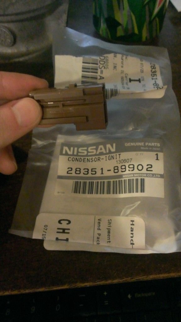

**** it, try to force me to fill this space out and **** but not enough damn room
Ignition condenser/capacitor
Check that out!!! 👆🏼👆🏼👆🏼👇🏼👇🏼👇🏼
