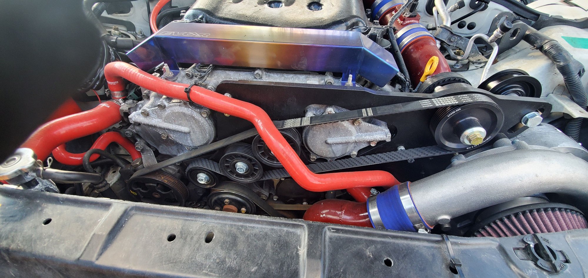

Here's the current setup

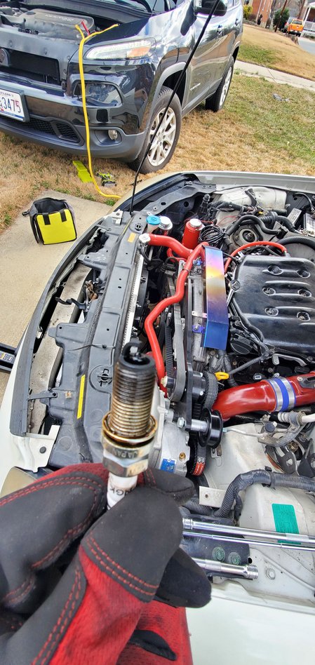

Pump is priming and while cranking you can smell gas so we have gas, there's no leaks that i can find so we have air as well. The plugs once I checked them are black and smell like gas as shown below
I can't confirm if the car is getting spark and I'm thinking this may be the issue. We got the car to start once and it stalled in a few secs. So now we are slowly eliminating problems as we go along.

​​​​​​Someone suggested that the belt routing was wrong but I've seen some routed this way and others routed differently so i don't know which is the correct way.

First replace all the spark plugs, while you have it all apart pull the fuel pump relay, plug in each coil pack one at a time with a spark plug installed, hold it about 1/4" away from the intake manifold with a leather gloved hand and have someone else crank the engine while you visually verify spark.
Install the new plugs, the coils, put the fuel pump relay back in. This is a good way to actually VERIFY spark.
Next OBD2 scan for any hidden codes just to make sure it's not something being missed, if you have spark then you're getting signal from crank/cam sensors so those would be pretty much ruled out regardless.
Then remove a section of the S/C piping between the SC and the MAF. Try to start the car now.
Who did the base tune on the ECM for the supercharger? My gut feeling is the tune is off but it's pretty straightforward getting the base SC tune on the ECM.

Put the old belt on so it's not driving the SC, it will run like **** because it's trying to suck air past the SC but it works if you're doing a really short drive like around the block.
Otherwise put the old belt on, take off the pipe in front of the MAF and put the air filter on right there, cap both ends of the SC so it doesn't fill up with dust.
Since you're just trying to get it to START I would just take off the pipe in front of the MAF and start cranking, not going to hurt anything as long as it's not a dust storm that day.
