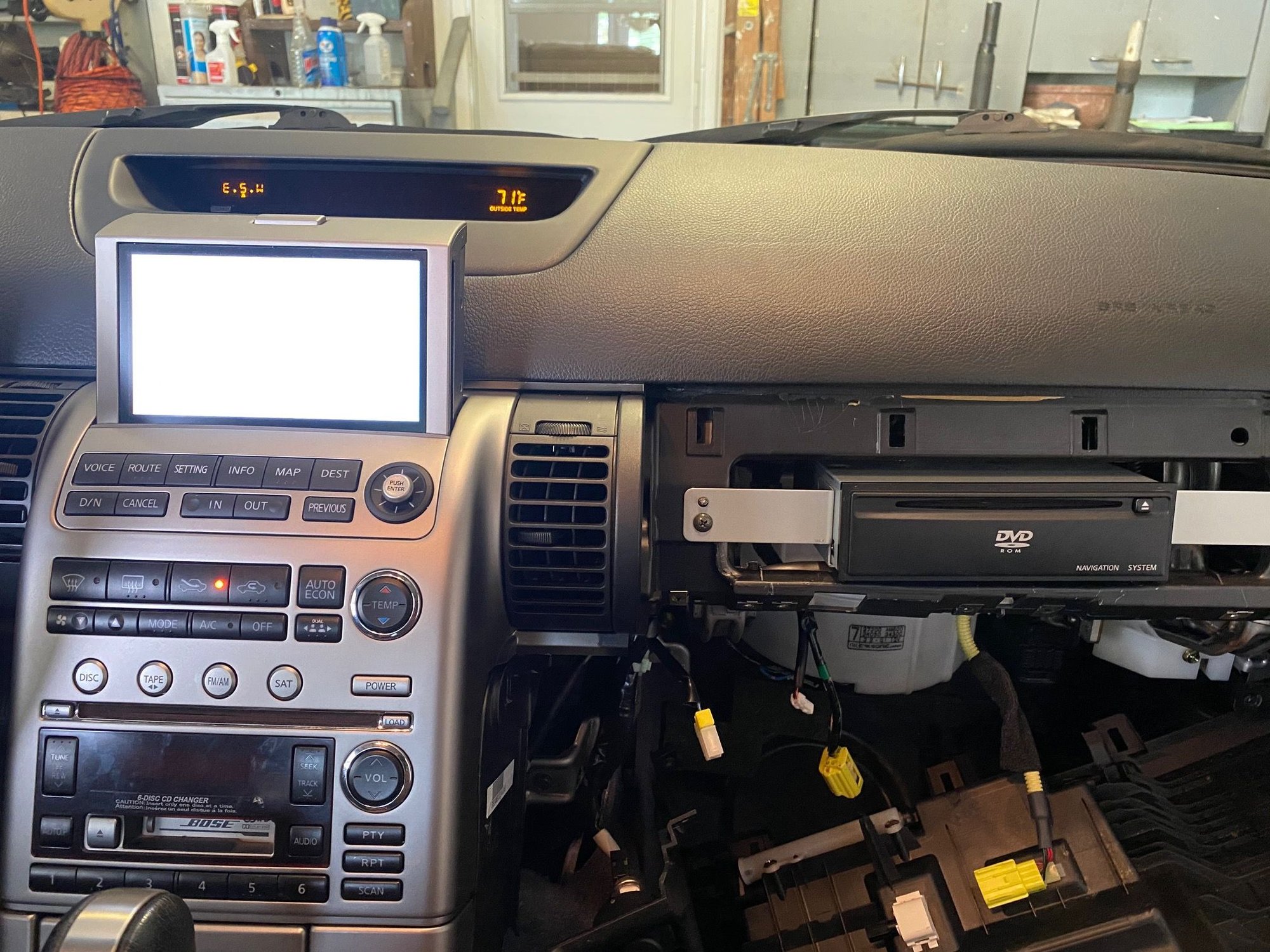

My wife's 2003 G35 Coupe with 22m miles, had an F0 error in the CD portion of the radio. It was a jammed CD. Removed the CD's and the error went away. CD player works great. Now the Navigation screen is light gray with no image. When you push D/N the screen gets darker.
Also, I tried to eject the DVD disc, but it won''t eject. I can hear the disc spin inside the unit. After a few seconds the screen flashes dark and then back to light gray. No image. I've pushed the voice button and the voice comes thru the speakers. I purchase another DVD Unit
and it does the same thing. See attached pic and video. Any help would be greatly appreciated. My wife just wants her baby back to normal.

There is no hole in the front of the unit. I took the top off the unit. I am not sure how to get the disc out since it is deep in the unit and there is no easy access to remove a disc.
Also, the display is only gray. To run the self-diagnostic mode you need to be able to read the screen.
There are no images on the screen only the light gray and dark gray for day / night.
Bought a second DVD unit. The same thing happened. No video on screen and the disc won't eject. Seems odd that this happens with two units.
Is there a reset for the nav computer?
Any other suggestions?

Sorry for the late reply. I removed the CD's by opening up the top of the changer. Disconnected the ribbon cables and took the board out. That allowed me to
remove the cd's. I re-assembled the unit and the F0 error was gone and the CD changer works and plays.
When the Nav didn't work, I took the unit back out and checked all of the connectors to the units. Everything appears fine.
When it still didn't work I thought it was the DVD unit and bought another one. Installed it and have the same issues.
If a fuse was blown, would I still have the screen gray with the night feature working. Also, when trying to enter the diagnostic mode, the nav woman's voice came thru the speakers once. My wife really wants to keep her car as original as possible. She bought it new and only has 22,000 miles on it.
Is there any way to test the video for the nav or any other suggestions?
