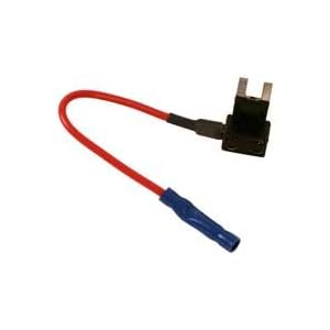

You won't even have to cut any wires if you're creative with a single small spade connector and a "add-a-fuse":
